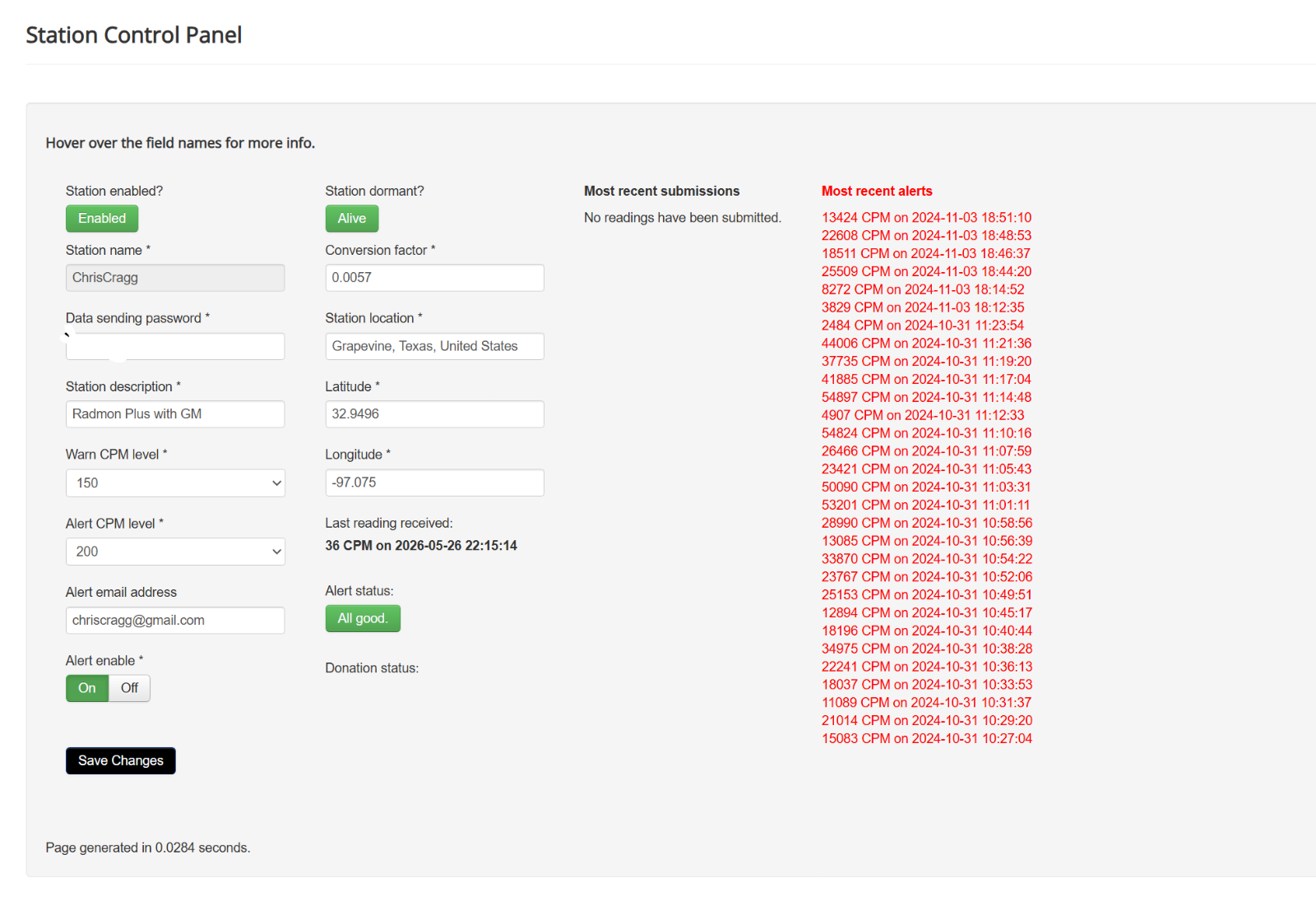

I've had my radmon account open for many years. I have never seen the graph update. It doesn't appear to be storing the data. The control panel page shows that it did receive data, but doesn't appear to put it in the database:
[corrupt image removed by admin]
Another odd thing is that my GK Radmon device reports "fail" after trying to send data.
Everything looks right in my configuration. Any idea what is happening?

Updated version with image attached, not embedded.

Hi Chris,
I see what is happening here. You are using the wrong case with your username. Instead of submitting with the user 'ChrisCragg' you have been submitting with the user 'Chriscragg'. The usernames and passwords are case sensitive, Chriscragg != ChrisCragg.
As you have been submitting with the wrong case username it created the data table with Chriscragg, so your submissions were going to Chriscragg, but when viewing the station page it is looking for a table called ChrisCragg. So submissions were going to the wrong table.
I have changed your data sending password to halt your submissions for now (so you don't end up with multiple tables and in more of a mess). I have renamed your data table to ChrisCragg so you retain your data, and I have also generated your graphs.
What you need to do now is change your submission method to ensure you are submitting to ChrisCragg exactly and also change your data sending password to match at both ends and it should all be fixed.
I would also take a look at your counter too - 51880 CPM on 2026-05-27 07:14:12 seems a little high to me.
