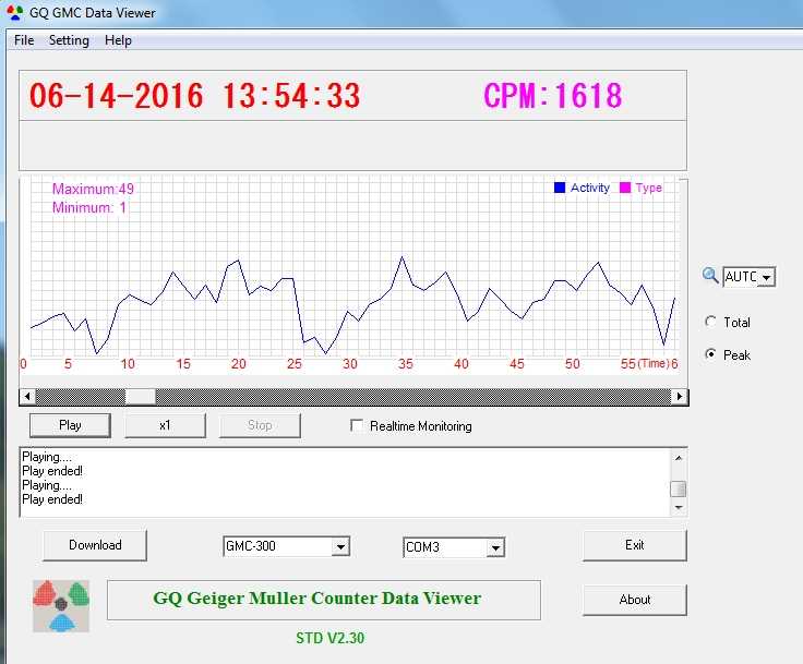

It's _really_ hard to get the log data to show exactly what I'm looking for sometimes, so though I did get a screenie of the log from the day it hit ~1700CPM, the highest reading I could get it to show was 1618 CPM. I'll include that here for GPs. This was the highest reading I'd ever gotten -sans for a few weeks after being injected with Indrium-111, which doesn't count for these purposes-.
The day I took that, the wind was blowing hard from the WNW (direction of the mill), it was very dry (probably in the vicinity of 10% humidity), and it hadn't rained in several days iirc. Definitely a dry day that day. It was also very hot. Probably in the 100°F range.
When I took the reading, I'd had it inside, noticed the wind blowin', and thought to pop outside and check, so I just went out the back door for a minute and got the reading... and almost needed to change undies when I saw it go up that high, then promptly went back in... I should have left it out a while, but I'm ashamed to admit... I kinda' panicked.
While outside, it went higher the higher I put it up in the air (so not coming from the ground, which has thankfully always tested low -after a rain the ground reads higher and the air reads lower, which makes sense-, but part of the point is, it hadn't been outside long and read normally both before and after I took it out, so I don't believe the temp/humidity etc. could've been messing with it -at least not enough for that dramatic a reading-. Temperature was probably in the lower 80°F's when I put it out. Humidity was low. I'd guess around 16% (that's about what it usually is when it hasn't rained in a while, and it hadn't.).
I only managed to scrape together the money to get this counter somewhere around January, but I did take it outside with me on the warmer days where the temperature was in the 60°F's or so (oddly enough, we get those here. My birthday's in February, and last year it was in the 70°F's on my birthday, so I got to have a barbecue! Wheee!), and never saw anything spectacular. If the CPMs hit the 50's it was a big deal, so that gives a gist.
The mill I'm suspecting (but am NOT sure at this point!) was one that processed some of the purest uranium on earth until just a few years back. It's known as Cañon City MiII, aka Cоtter MiII. They have NOT cleaned it up. The leach pad (or whatever they call it... I grew up in gold mining territory, and it looks just like a leach pad to me, only with different stuff in it) is HUGE and wide open... ~576 yards (1/3 of a mile / .53km) at its longest point and ~167 yards (1/10th of a mile / .15km) at the widest point (used google earth to measure). Here's a link to a view of the sucker: http://tinyurl.com/cоttermill

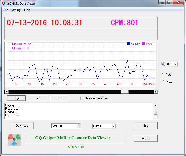

I'm going to include the log file from today in case anyone's interesting in taking a gander at it. You can tell when I took it outside, when I got into the truck up until I put it out the window, when I went into the grocery store, etc, just from looking at the CPMs. Below is the rundown of where I went, _some_ times for references, etcetera, to go along with the log.
I hung it up this morning, and it was setting off the alarm, which I had to increase to 200CPM to keep it from going off all the time, so that means it was =/>200 while it was going off. A wee bit after 9am today I went into town and, since I wasn't driving, stuck my hand out the window holding the Geiger counter along the way. It went up-up-up heading toward the main drag (a few blocks North of me), and then started to drop as I got toward the grocery store to the East.
It was in the ~20's-30's range in the grocery store (even when I put in the cooler that holds the flounder, salmon and catfish), except for the aisle with the nuts and the aisle with the cat litter (incidentally, the nuts and cat litter are on the same shelfy thing opposite one another, so one's in one aisle and the other is in the next one over). I may have missed some peaks etc. 'cause it was in my purse for part of the shopping trip.
After the grocery store (which is on the main drag), I went to the post office to the West (and a block North of the main drag). As I went West, the counter kept going up-up-up and after turning North, even more up, 'till peaked at 801CPM in front of the post office (I'll include a screenie of that from the log), and started to drop (the truck was blocking the wind once it was parked). This shows at 10:08:31am on the log (omg that means the grocery store took the better part of an hour!
) The temperature had gone up to the lower 90°F's by the time I got home. The humidity's been at its usual 16% today. The wind, oddly enough, was blowing from the North, at least while at the post office (tossed a bit of dog hair out the window to test
). I don't know of anything North that would do this.
I do wonder though... the wind had been blowing in the direction of the post office the previous 2-3 days. Could a hot particle have lodged itself somewhere? All I can do is speculate.

Now OldMule, your area is reversed, with the outdoor readings higher. If these very high outdoor readings correlate with dry conditions and wind from the WNW, it seems likely to be dust blown from the dried up edges around the Cotter Mill leach pad (it's of course just conjecture at this point). But I also see a good match with Safecast data from 2013. The background in your area, both then and now, is around 50-60 cpm, likely due to the elevation (cosmic radiation being less attenuated). Under a solid roof, the drop to 20-30 makes sense. On the Safecast tile map (here) if you right-click on one of the tracks, you can query the data and see the cpm value, who submitted it and when. The mountain passes near Denver go above 100 cpm.
