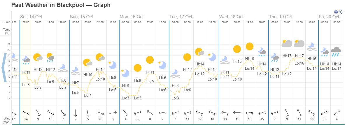

This is from the web. The past week of weather data for Blackpool. I live very close to the coast (1.68 miles) and our air is usually very clean. I'm in a 0% Radon area. Whenever I have seen this kind of thing I have always assumed a cosmic event or something. I have four other counters running at home in my office at the moment. None of them picked up anything. This is the weather for Blackpool over the past week:

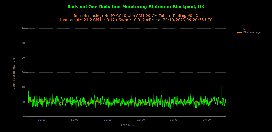

And another strange spike this morning at exactly 43 minutes past the hour again. Hmm. I have just checked Radlog.exe logs and it appears right around 05:43 is when it rolls the logs, saves the graphs and does it's shared data thing. This doesn't account for what looks like a bonafide detection, and doesn't really account for anything either side of this time slot but I suspect Radlog.exe does some hourly things too. I'm going to restart Radlog.exe and see if that makes any difference. Daily log is attached at the bottom. Nothing unusual either side of the spike.
2023-10-20 05:43:56, 117.3

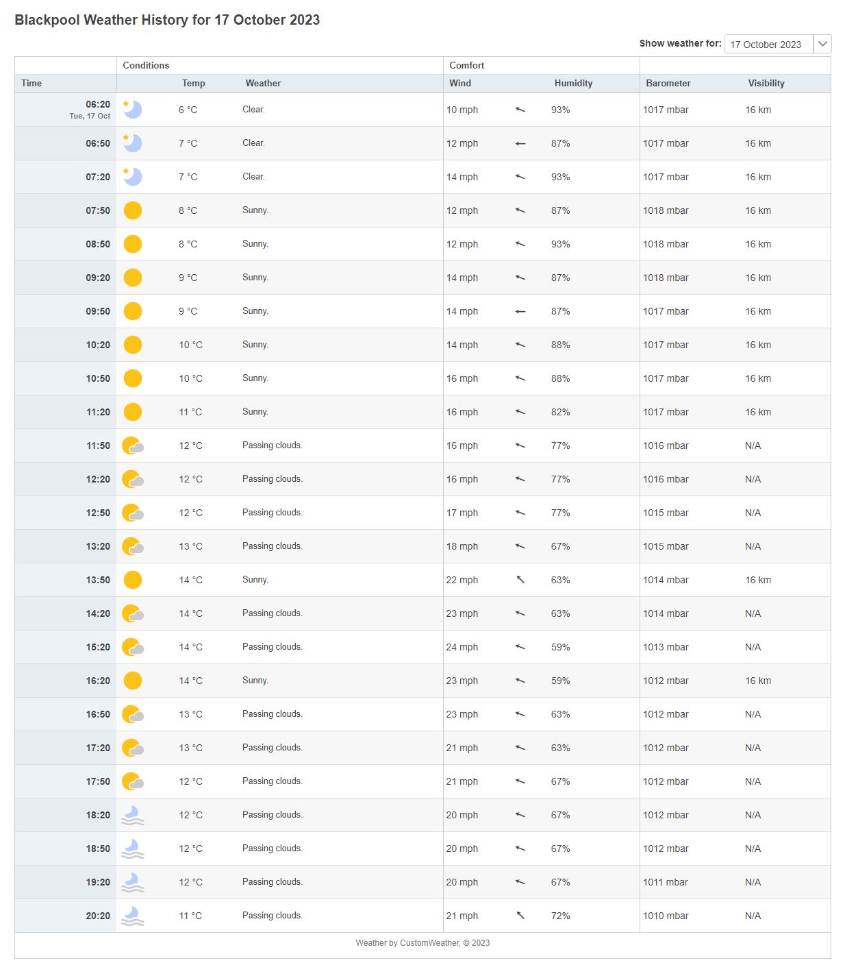

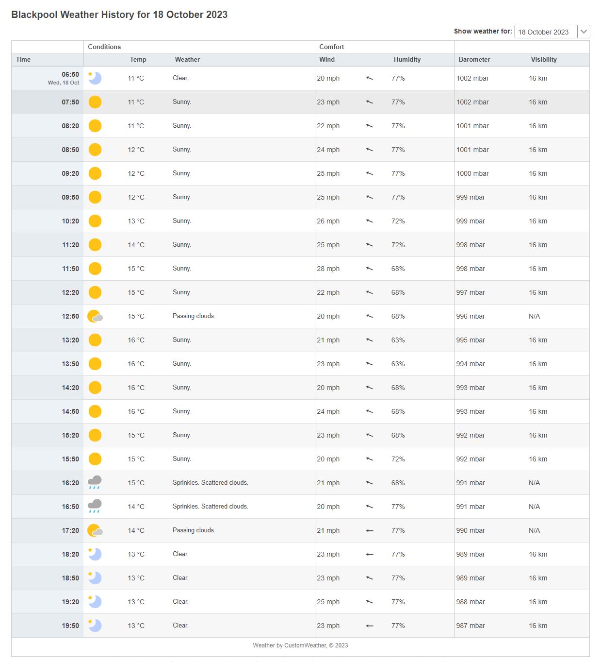

I did manage to get some historical weather for the 17th and 18th when the event(s) started happening. See images below. I very much doubt water ingress/humidity would be the case. The unit is quite well sealed up (99.9% sealed?) It has some Kapton tape over a slot in the front of the case and temperature changes can bee seen by the Kapton tape being sucked in and outwards. The buttons/switch/cable gland are all super high quality hermetically sealed military grade parts, all with their own seals. I will check it over though this weekend. Maybe wipe all the cobwebs from it.

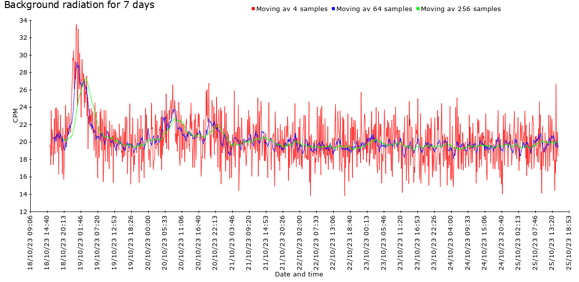

I'm really going to have to put this down to either a Radlog.exe, or a PC issue. The timing of the events was too similar and when looking through the Radlog.exe logs it was apparent it was doing it's homework right around 43 minutes past the hour. After restarting Radlog.exe it hasn't shown any strange spikes at all so I can only really put it down to the software right now. The only thing I have done is restart Radlog, nothing else. I did have a quick look in on the counter and it looks squeaky clean inside, as it has done since fitting it.
This the the past 7 days after that, what looked like a real proper event. No spikes, but there is another little rise in CPM after the proper event.
