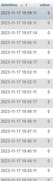

Seems you are sending a value of 0 to Radmon. Could you show you're code you are using? And is the upload value correct on your end?

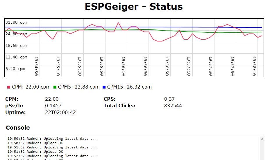

I have just had a quick look and your counter is submitting 0's. You should check that the ESP8266 is getting a proper count from the CAJOE counter
See here:
You can use the 'Status' page on the ESPGeiger to check if your counter is working poroperly regardless of it's submission to radmon.org. Go to the ESPGeiger main page and press the 'Status' button and there you can see if it is counting properly. If you are getting 0's on the status page, it will be sending 0's to radmon.org.
