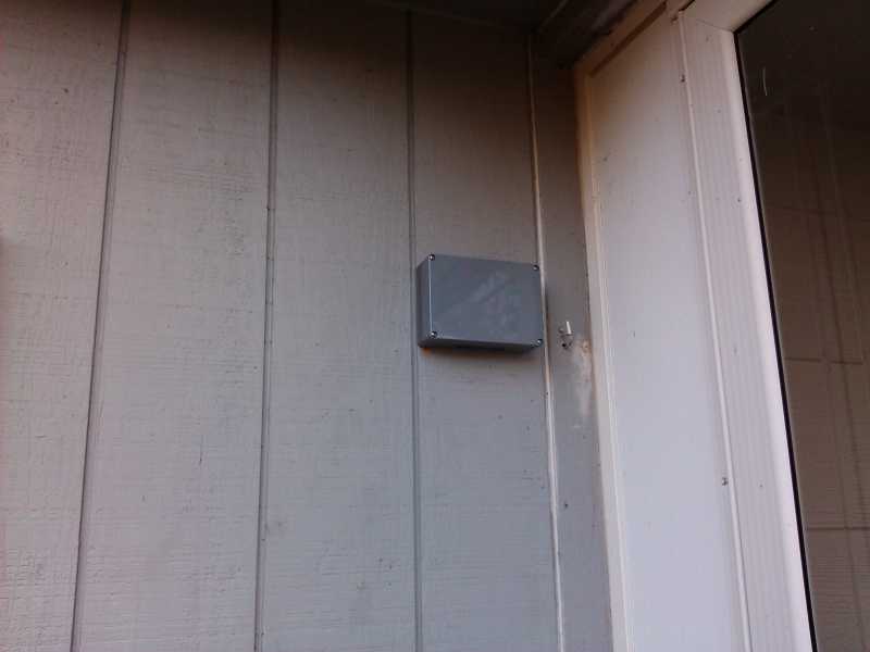

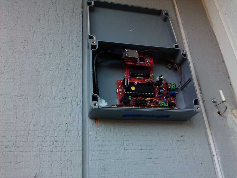

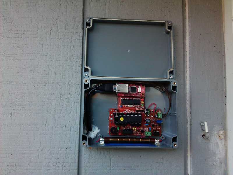

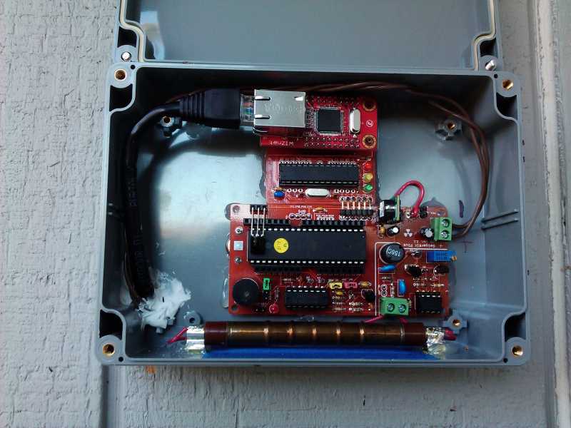

Attached are some pix of mine.
A close look and you will see a blue line and a slit just under the g tube. I cut a opening in the enclosure and then covered it with a piece of painters tape to keep bugs out.
I figure it might kill some of the alpha getting to it. But, if there is that much, not sure I want to be outside!
Cheers..........

Hey Tom, that's pretty cool, nice setup. I see the enclosure has a seal for the cover too, that's good. On the tube your using, I don't believe you will get Alpha, I think that requires a open ended type of tube. The closed ended tubes will do beta and gamma. I'll get some pictures shortly of mine. Nice job !
