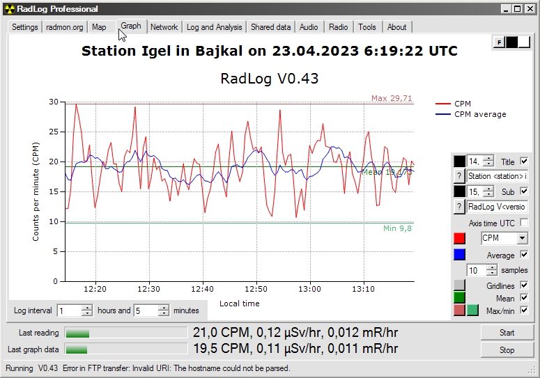

I don't use any antivir, firewall and ISP, but use win XP on alone PC.

But previous post I show my profile at radmon.org. It correctly opens on any of my browsers:
3 years 4 months ago #6438 by Igel
I talking with You on radmon server without problems, and much other soft works such us http://www.gmcmap.com/log2.asp?AID=03856&GID=19660136604 monitoring. All except RadLog..
3 years 4 months ago #6439 by Simomax
Can you access HTTPS, secure sites in internet explorer? Try https://radmon.org and verify you have an encrypted connection working with IE. Radlog won't work without current encryption. Try in internet explorer as this uses the PC's encryption system, not the browser. For instance, Firefox uses it's own encryption system so that will work but that is all wrapped up in Firefox. If you can't get to https://radmon.org using IE then radlog will not work on that operating system without updating the encryption cipher and root certificates, and I don't know if that can be done with XP.
The following user(s) said Thank You: Igel
3 years 4 months ago #6440 by Igel
Yes, only IE can't open https://radmon.org/ . And here is no way to use RadLog on XP? Only gmcmap.com working.
