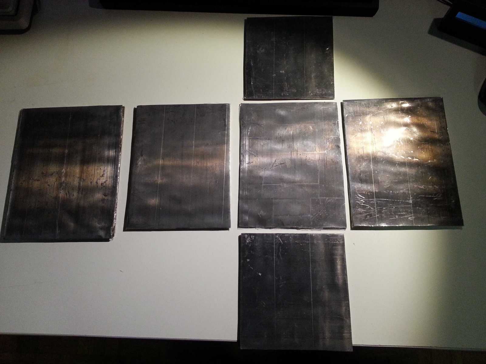

My setup is a set of 6 lead sheets, 1/16" or 1.6mm thick, bonded to thin plywood for strength and wrapped in clear tape to prevent direct skin contact:

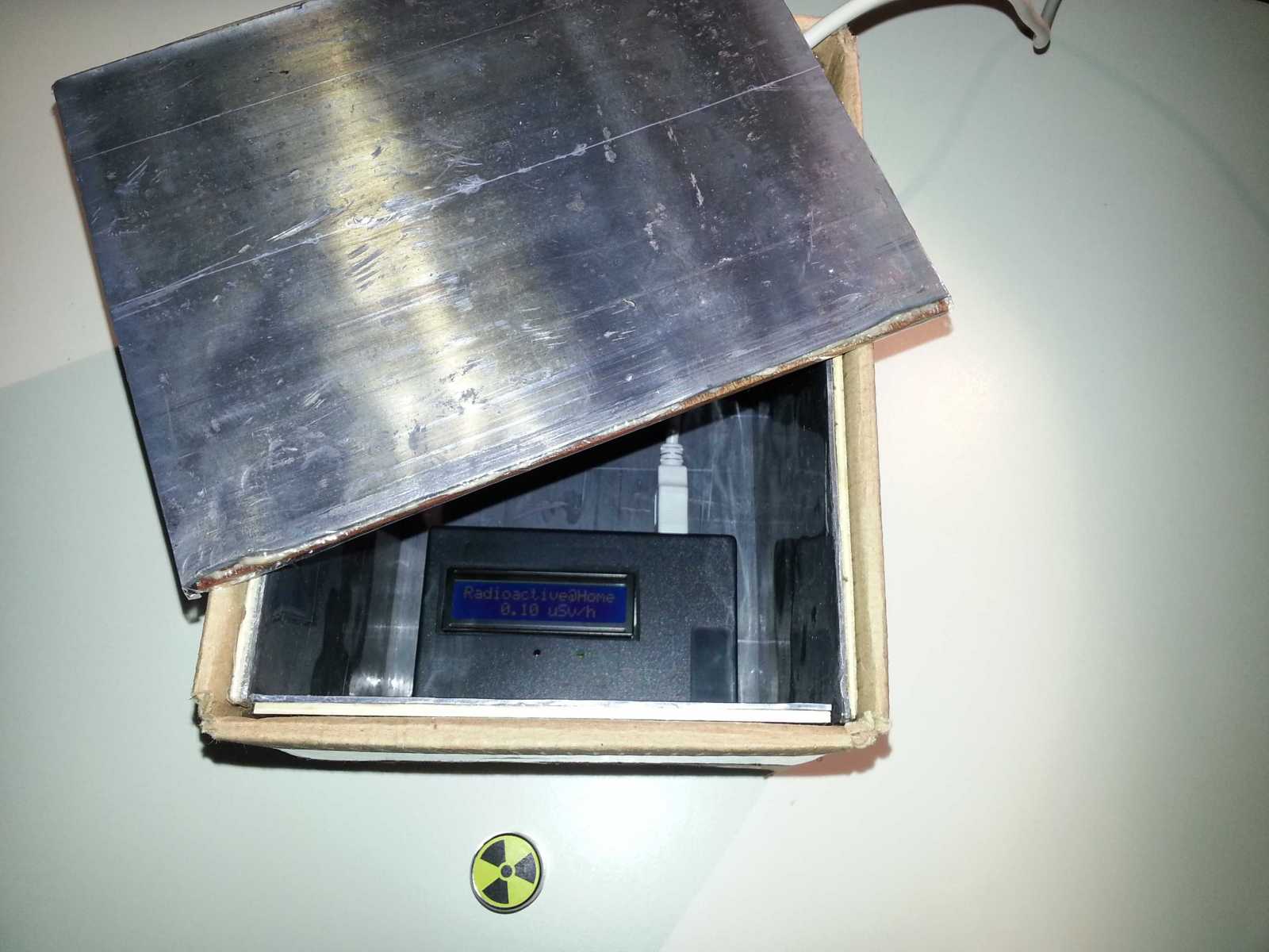

These slide into a simple cardbord box, then the detector is put inside:
The lead effectively stops radiation from my Uranium Glass beads, but unfortunately it does not seem to reduce the background radiation reading. I was hoping to see a significant drop and then play with the cover opening to check with satellite passes, but this will not work for me. I have to conclude that the detector is getting mostly beta from the beads (Uranium decay products), and background here is mostly gamma. To stop all gamma except from above, this experiment really needs lead bricks, I guess.
