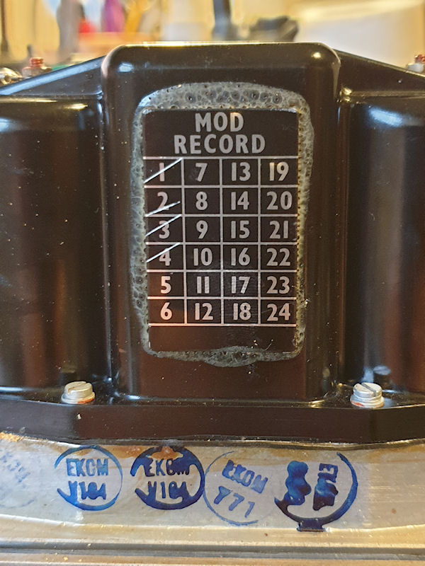

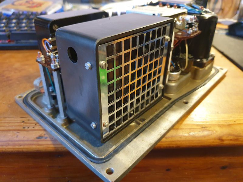

I have just dug mine out (complete with Haversack No. 6) to have a look. I completely forgot that it has a laminated card inside and a note showing it has had a modification. I didn't realise how interesting this meter is. I popped it open for the first time and wow, it is very well built. It has an ion chamber that I have never seen before. It seems half open to the elements. I expected something similar to the CDV-715/717/720. Also interesting that it has an aluminium plate under a cover you have to unscrew. I assume that is to shield beta? That hole you mention for inserting an alpha source goes right into the ion chamber. It also appears to have had four modifications in the past. Looks like each was officially stamped inside too.
I still cant budge the battery cover and one of the screws close to it has also corroded and rusted so some special persuasion is needed I think. One for another day. The insides look good though with just a tiny bit of leakage by the gasket on the battery compartment, so it may be salvageable. I should be able to get the bakelite battery chamber out from the insides and that should give me access to the other side of the battery cover. Again, one for another day. Its a nice meter though. Would also make a nice self defence weapon due to it's weight and strength!
