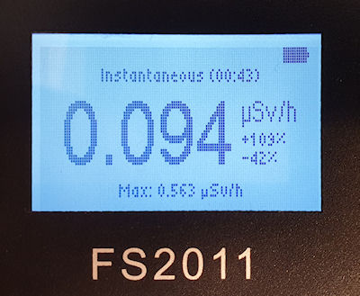

Replied by Simomax on topic Custom firmware for the FS2011/FS9000/NR-950/YT-203B Geiger counters
Ugh, lets try this again... 3rd try at not loosing my text! Trying to post with fat fingers appears to be harder than flashing the firmware!
Hi Gissio,
Success! I have managed to backup the original firmware and flash your Radpro 1.3.0 on to my FS2011. It was pretty easy and all worked first time following your instructions. It was harder downloading the drivers for the ST LINK dongle as they wanted details, email etc... Meh.... It appears to be working well so far, much better than the stock. The original firmware was reading double uSv than it should have been. I think the conversion factor was set for the HH614 tube and not the (clone/copy) J305 that was fitted. Comparing to a couple of other counters I have laying about, your Radpro 1.3.0 appears to be reading correctly now. I have since fitted an original J305βγ as I broke the original tube trying to remove it. The tube still works but the metal caps have fallen off each end. I can still use it but I'll have to crimp some wires onto the wires coming out of the tube. I will probably do this and refit it at some point.
I couldn't find my Gigaohm resistor (somewhere in my empire of dirt/workshop) but I did read the voltage before and afterwards anyway. With the meter burden it was reading 176.4 volts and with your Radpro 1.3.0 it is reading 179.8. I have fitted new batteries since reading the original though so that could be the discrepancy.
Cheers, Simomax
