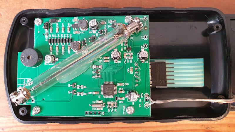

Whoo! My FS2011 landed today, and I have the ST-LINK dongle too. This one does have the GD32 MCU, so that's great that gissio has firmware for this MCU as the stock firmware really sucks. Interestingly the tube in mine appears to be a J305, but there are no markings on the tube that I can tell. it seems to be the exact same size and construction as a J305. I'll remove the tube and inspect it further later as it has been soldered in. I will probably have a play with the counter and try updating the firmware this weekend.

Nice! Indeed it looks like a J305. By the way, a user posted a similar photo here: https://github.com/Gissio/radpro/issues/2 . He also mentioned that his device has a J3 marking on the glass.
One more thing: before flashing the Rad Pro firmware, could you measure the voltage on the tube, and check it is the same after flashing? I can't test this as I don't have a GD32 device with a J305 tube.
