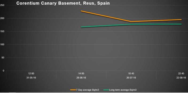

The measurements from the past month, split into 7day and long-term averages, accurate to plus or minus 14Bq/m3, according to Corentium's Radon Self Inspection Report

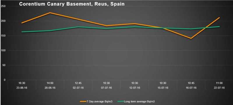

The measurements from 30th May until 22nd July, again split into 7day and long-term averages, accurate to plus or minus 14Bq/m3, according to Corentium's Radon Self Inspection Report
Why there would be a steady, if slight rise, in Radon concentration during the Summer months, when the perceived wisdom is that if there are no changes to the surroundings, then the Radon level falls naturally during this season, I don't know.

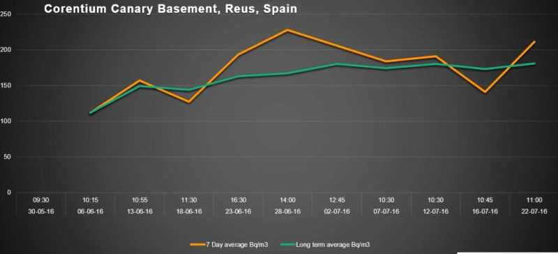

The level of radon seems to have stabilised in the basement room as the long-term average for the last month has never strayed from 176 to 180 Bq/m3
