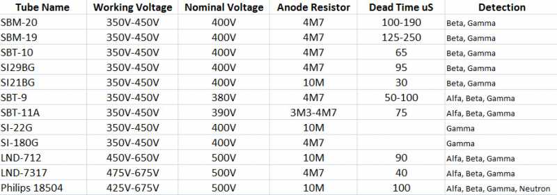

A small chart to compare tubes.
[img]https://dl.dropboxusercontent.com/u/3572198/Chart%20-%20GM%20all%20tubes.png[/img]
To save the calculations for you.. :P

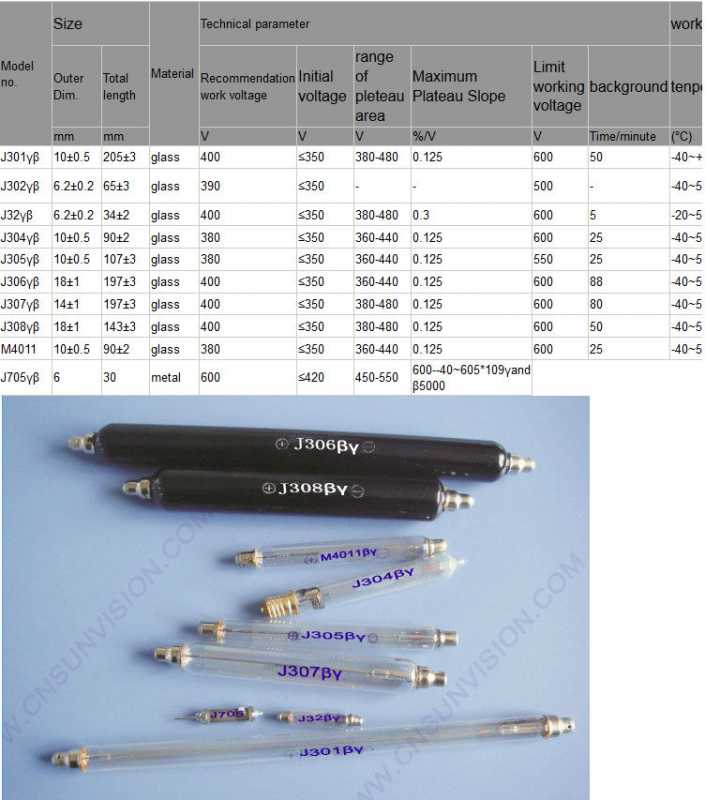

I would add that using alpha/beta filter is definitely required when extracting conversion factors with this method. So I'm sure we cannot use the chart because we don't know if alpha/beta filter was used, I suppose these reading where taken without filter. If you make a practical test to extract the factor use at least thin aluminum foil between the tube and radiation sample to cut alpha and beta.
I attach electrical information for the tubes.
