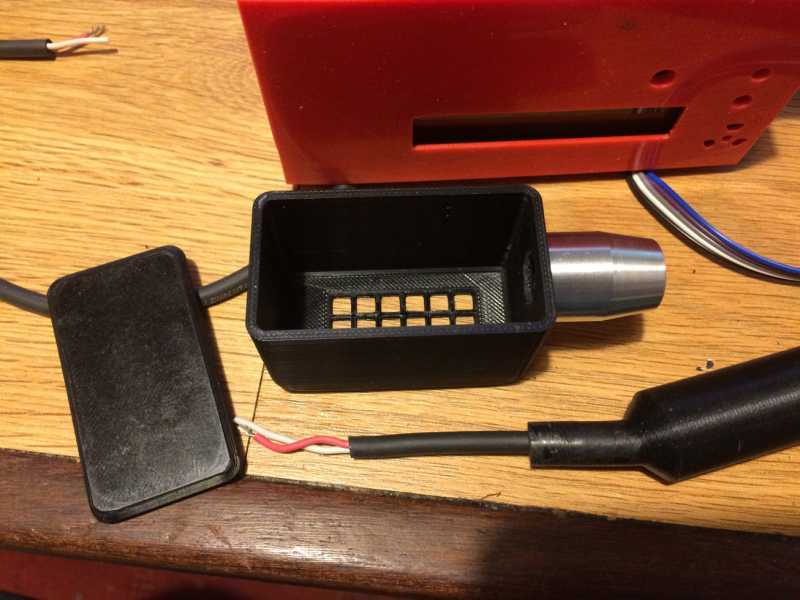

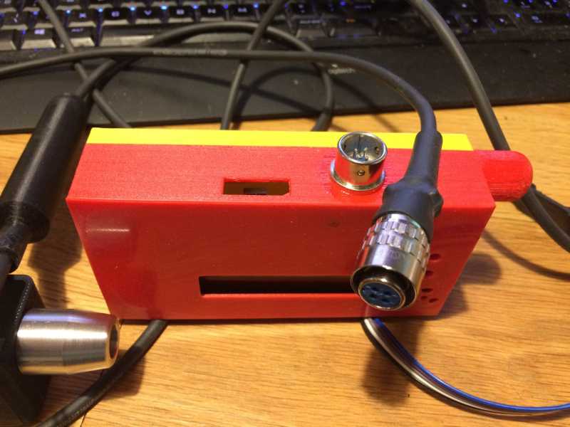

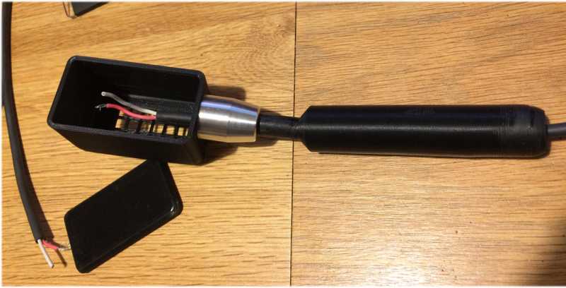

On the expectation that the other tube will eventually turn up in the post I printed a second tube holder or 'wand'. This is a design leached off Thingiverse, but modified with an alloy furrule where the handle fits into the rectangular box holding the SBT-11A tube. The ferrule is epoxied onto the box and offers a stronger joint. The 5mm connecting cable runs through the handle.
The final image shows the 1 meter cable is terminated with a push-to-connect 4-pin plug, it's polarised (of course) and is very quick to connect and disconnect. The only ones I had in stock are 4-pin plugs and sockets so only two of the pins are acutally in use.

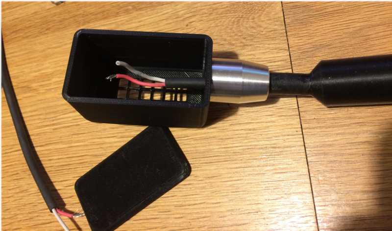

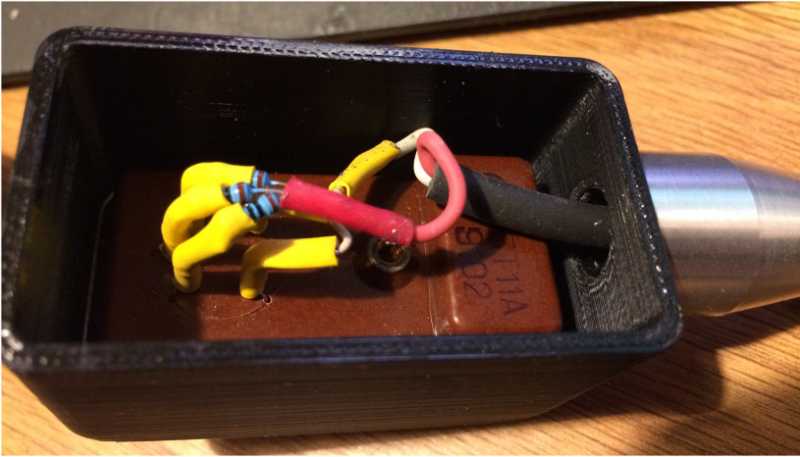

With regards to connecting a lead to the SBT-11A - although some owners like to solder directly to the pins I was less than enthusiastic about attempting this. I had used a dedicated socket on my first SBT-11A and it worked well (meaning soldering was not a requirement to get a good connection) so I looked around in my junk box for something similar that I could use. I had no luck finding a compatible 5-pin socket but I thought maybe I could just extract the female pins from a 4-way computer fan plug because the pins looked to be about the right size. If you press the tiny retaining tabs the pins pull out of the plastic block and I tried pushing them onto the SBT-11A pins - a perfect firm fit
OK, not as good as a dedicated socket perhaps but it saves risking damage to the tube by soldering. I clipped the socket pins as short as possible and soldered a 10M Ohm resistor to the three which plugged onto the postive terminals, those for two negative pins were simply soldered together for a common ground connection. I used heat-shrink tube to cover each of the five pins including the resistors so it's all neat and tidy.
