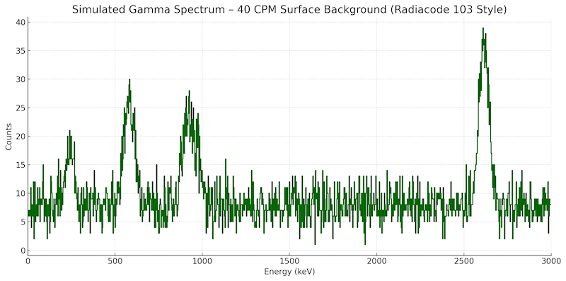

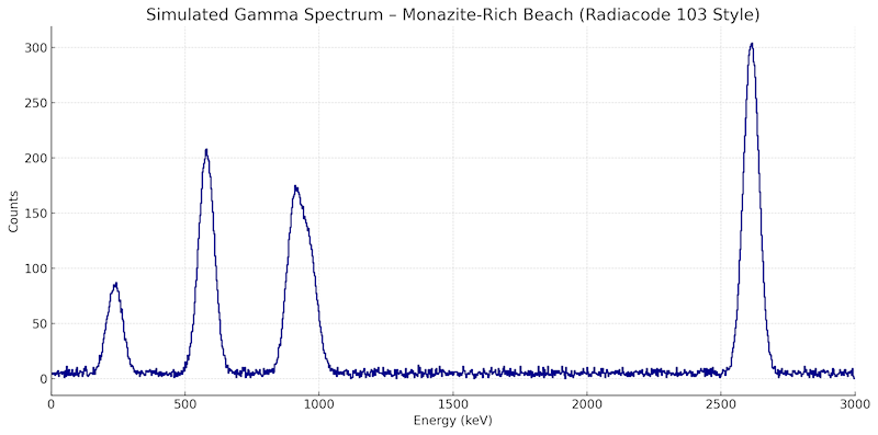

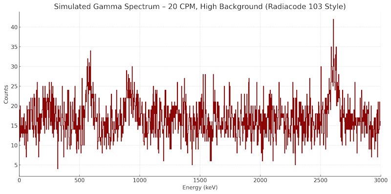

I have just used AI to produce some fictitious spectra based prevalent NORM isotope. When I talk about signal-to-noise ratio, hopefully the following will show that.
Can you tell what this is in this spectrum above? I know what it is, and I can see it there, but can you tell just from this spectrum? The signal is low and background is high, so we have a low signal-to-noise ratio, or SNR.
Here I have turned up the isotope and turned down the background a bit, it's starting to take shape, Can you tell what it is now, probably if you were experienced enough and knew your tools enough, but it doesn't really shout anything. This would be a medium SNR - some signal, some noise.
Now, what about this? This is showing a high SNR - plenty of signal, low noise. This is showing a very clear picture now, so we see the nice peaks, look them up in our library. Pb-212, Tl-208, Bi-214 and another huge peak at 2614 keV (Tl-208 again), we cross reference them and bingo! We have identified Thorium-232. And we knew this because we saw the data and cross referenced it from an isotope library. This is half of the battle.
But where is it, how, why and when? In the simulation I took my Radiacode to the beach and noticed the dose rate (counts) was higher. That's the first spectrum above. I then placed my radiacode on the sand and it increased in dose rate and I started to see something. Could I have nailed it on the 2nd spectrum? Personally, me, yes probably as I knew where I was and that gives the other half of the picture. Simply know what location you are in and the natural geology of the area helps massively. Then I decided to dig down until I hit black sand and I placed the radiacode onto said black sand. Boom! We get our really nice crystal clear spectrum (last picture). The signal is so much more than the noise it creates a perfect picture.
Now, and finally (if you got this far through, well done!) the counts you are experiencing, the signal-to-noise ratio you will be experiencing with be something between the first and second spectrums, and probably more akin to the first spectrum. Without being able to get a good signal from a particular isotope, the background will muddy the water. There are only two ways to make the signal better - 1, reduce background and 2, amplify the signal. Reducing background, when you are measuring an isotope in background is impossible, so we rule that out. The 2nd, amplify the source can't be done as radiation can not be amplified. The best thing we can ever do in this case is to move the Radiacode closer to the source. If you can't get closer to the source you will never get a good spectrum, period. If you can move it closer and get a discernible increase in counts over background, you may get something if you leave it in the same spot, powered on and sampling for days, weeks, maybe months, then you may see a little bump in the background curve and maybe you can use that to identify the source. And even then, once you have identified it and roughly where it is, what do you do about it? If this is an old house and maybe some old brick or stone has a hot spot, are you going to start pulling your house to bits because of this? It's a tough one, really.
