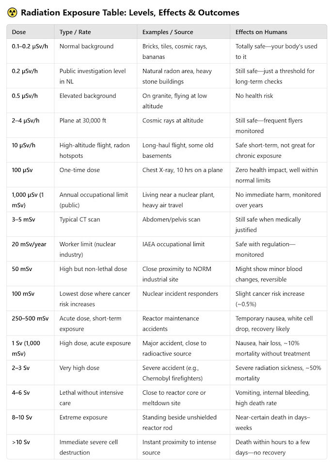

I used AI to generate a table with exposure levels and their effects and outcomes. That is in the image below.
It also gave me a few notes:
- The LD50 (lethal dose for 50% of people) is around 4–5 Sv, untreated
- Cancer risk starts to be statistically significant at 100 mSv
- Regulations aim to keep public exposure below 1 mSv/year (excluding medical)
