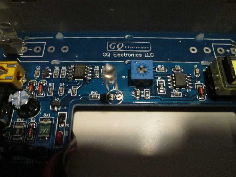

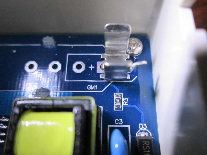

Tried to get decent images, hope this helps. As mentioned, it clicking away for the normal clicks it does for the back ground radiation, but you can hear it, like double clicks for each detection instead of the normal click. I just want to make sure that I'm not shortening the tube life without the proper circuit to run the tube and detection. Also trying to find the best cable to us too. Right now, I'm using a length of cable that use to go to my old heathkit weather station, its one of the sensor cables that was for the outdoor temp probe, its shielded, 2 conductor inside a braided ground/shield. Thanks

Ah ok, its R3, (3 mega ohms) you need to remove.
If you heat both sides up with a chisel shaped iron, it will just come off. Be gentle or you'll rip pads off, once its hot enough it will move easily.
Then solder a standard 10k resistor from the diode D3 to the fuse clip. Order a standard 3.3Mohm resistor from somewhere and put it at the tube + end.
Hopefully, that will work.

Ah, ok, I can the surface mount one with no issues, deal with them all the time at work. Can probably get the 10k from there as well along with the 3.3M one
thanks Dan! How ya doing with version .42 ?
