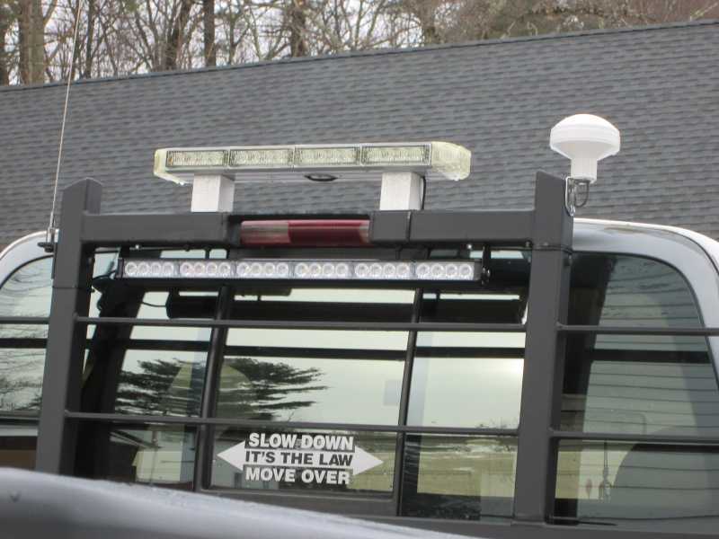

Just swapped out the 5 foot length to a 15 foot one on my mobile, vehicle dome unit project. Getting tad higher readings, quite a few double and triple clicking going on now
suggestions? perhaps what, I believe, Dan stated, moving the anode resistor from the unit to the tube end?

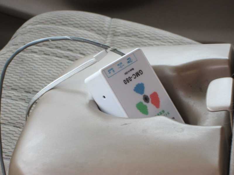

So my mobile attempt unit has been running good for about 2 weeks now since last posting about it. I have to reread thru the postings, so my readings/counts are basically doubled with the longer 15 foot cable, is this a capacitance issue ( install a cap) or move the anode resistor to the tube end would bring back inline? I can live with these readings anyways since this is my GMC-200 unit with no display to mostly going by audio clicking rate would alert me to a raise in level on the road. Also going to be adding a Arduino Uno unit to it with a display for counts, etc.

So,to revisit this one again, I have had my unit on the truck now for about 3 weeks. I'm using one of my spare GMC-200 units. About 15 feet of cable. Appears to be working ok but unlike my indoor unit that just clicks for every trigger, the mobile one seems like its a double click for every detection. In this listing, there was a mention of moving the anode resistor to the tube end, would this take care of the double clicking?

Gee, all your circuit guru's out here and no plies? But I did come across this nice writeup/explanation thou and have a better understanding now, that RH Electronics. But for now, without going this route, I'm running a 10 foot length of shielded sensor wire and getting double clicks. Also, for the time being, running GMC-080 counter for the experiment.
