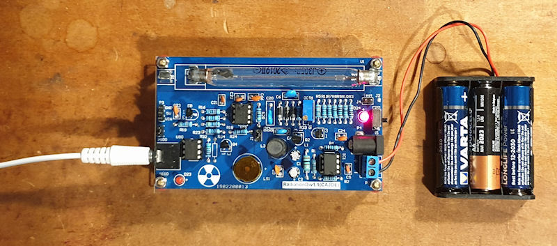

"I imagine that I want to collect data in a place without an internet connection, can I save the data on my PC without having a connection?
2 years 10 months ago - 2 years 10 months ago #6764
Replied by Simomax on topic "Is it possible to work without being connected to the internet?
You could use the Radlog software if you are running windows. The CA JOE can connect to the audio input of the PC using the 3.5mm socket on the counter.

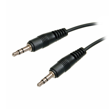

Exactly what type of cable is that? Where can I buy it? thank you
2 years 10 months ago #6775

Pyradmon.py is available under the Software menu above and is compatible with posting to this site's map display. As far as I know, Geigerlog allows posting data only to the GQ map (IMHO the map presentation here is much better). Either one will log locally with no Internet connection, with software support available on the respective website's forum. The audio cable plugs into a Mic in or line in connector. The sound is just clicks, not worth recording unless it's with a video.
