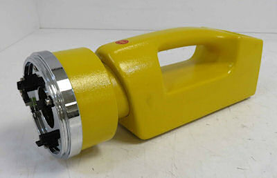

I have just bought a 'PBI Microbial Air Sampler SAS Super 90' just for the simple fact it looked proper funky! I have no idea if it works, or how it works, or even exactly what it does, but bought it for shits and giggles. I paid £15. Working, they are going for about £1000!
I care not for testing microbes in the air, so I figure I can make something with it. So far I have thought I can turn it into a ridiculously powerful flash light. Something around 100w LED. I could use a liquid cooler in the body, LED and smallish heatsink at the end, use the display for something, temperature, power and battery remaining, and have a large LiPO pack over my shoulder. Or I could turn it into a nice portable PM2.5/PM10 air quality meter, and I have all the parts for that already. Or I thought of maybe a portable homebrew Radon gas meter. I could pull air inside the body and have it run through a filter. There could be a GM tube close to the filter, with a servo operated shield that shields the tube from the filter when collecting air, then samples for x seconds, then repeats. Any gamma radiation (Radon decay chain) coming from the filter would be measured by the counter.
I really think I have to do something with it because it just looks so cool! There is some kind of cap missing from the end, maybe a filter or something, but that doesn't matter. Anyone have any ideas also?

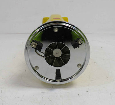

You are correct the end should have a holder for a filter and dust cap. The filter and its cap could be sterilised, usually by autoclaving. The body pulls a known volume of air through the filter in a set time. The filter is then used to seed a culture, from which the number of organisms per cubic metre and their type can be identified. Many moons ago I used a very crude system with a hand pump and attached filter to measure the number of bacteria in the air in laboratories. You could use a plain filter paper in a suitable holder to sample for radioactive particulates in air!
