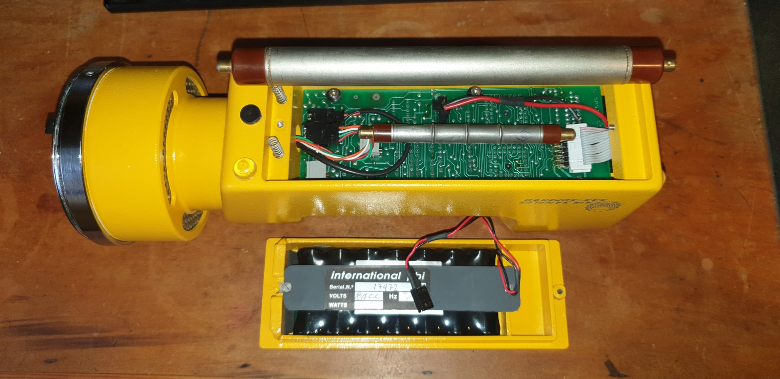

I received my SAS Super 90 today!
The space inside the case isn't large enough for the SI22G tubes. Plenty large enough for SBM-20s, but I wanted something with the sensitivity akin to the SI22G. I'll have to look about for something suitable, or think of something else.
4 years 9 months ago #5918 by mw0uzo
Replied by mw0uzo on topic SAS Super 90!!
Haha, so cool. Shame the big tube doesn't fit but oh well, that's for a small pancake tube anyway. Plenty of room to fit a counter PCB in and other bits, and a high capacity li-ion would replace those old nicads...
4 years 6 months ago - 4 years 6 months ago #6033 by Simomax
Replied by Simomax on topic SAS Super 90!!
I have just bought a tube for this project. Not sure exactly what model it is, either SI8B or SI14B. Will have to see when it arrives, although either model is good. 80mm case and about 60mm window. Will be good for hard and soft beta and gamma.
Now I just need to find some other tubes to fit in the base for background monitoring.
ETA: The seller has another 5 available (at the time of writing) and very reasonably priced at £35 each. Looks to be UK postage only but worth checking yourself if in a different country. Ebay link here: www.ebay.co.uk/itm/255391380382
