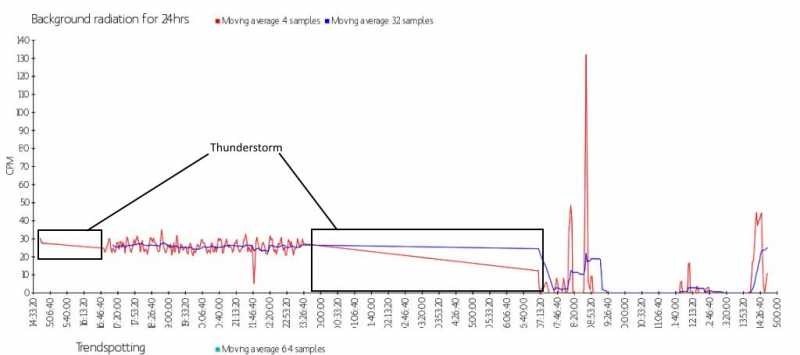

Some oddness noted
At the beginning of the first, minor, thunderstorm the equipment was switched off as I have had electrical items fried over the years in previous thunderstorms. When I switched back on all was well and working normally. For the second storm, which, unlike the first, was accompanied by moderate rain for about 20 minutes, this odd behaviour occurred once the Radbox was switched back on again
I don't think it's radiation related, although the casing of the Radbox had dried rainfall residue on it. I'm a bit panicky that I didn't switch everything off before the electrical activity in the environment ramped up and some sensitive components may have been adversely affected
I'll keep an eye on it over the next 24 hours.
11 years 4 months ago - 11 years 4 months ago #1077
Just checked the graph a few hours after your report. Looks like its settled back to its usual place, good news. Hopefully nothing to worry about

11 years 4 months ago #1079
Replied by Frank on topic The radmon.org radbox-20
That was strange, almost looked it took out something but Dan stated it looks like it came back.. haven't checked the chart yet.

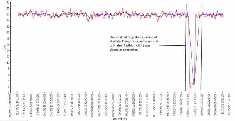

I'm not sure if this is either a hardware, software of Windows issue
Yesterday when I was away from my pc the cpm dropped fairly dramatically and then trickled along fairly steadily until I closed and restarted RadMon v0.41. After the restart normality returned. I have no idea what went squirrelly or why
Replied by bethsalem on topic The radmon.org radbox-20
