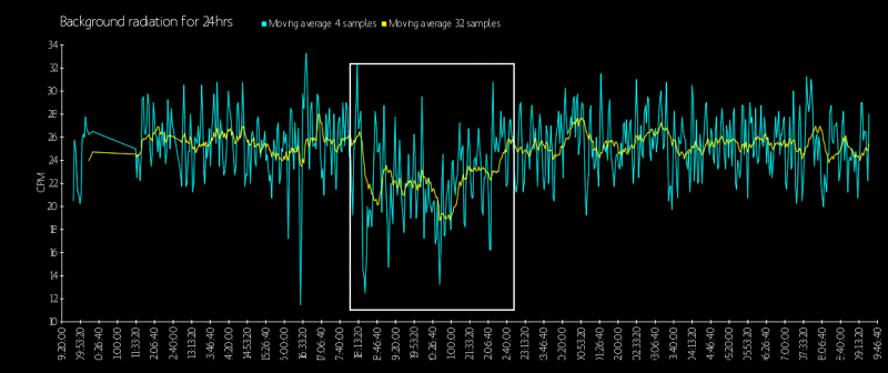

Another observation about real/imaginary differences between day and night detections now that the box is outside. After sunset last night there was a noticeable dip in the cpm for a few hours before it returned to average. The weather was roughly 15C, 60% humidity, cloudless skies and a stiff breeze blowing from the north-west.
I've posted some screenshots so you can see what I mean.

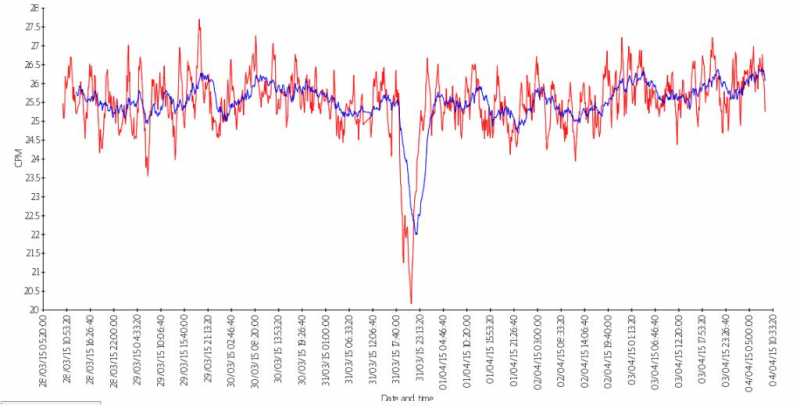

Firstly, I'm using the same type of GM tube, an SBM-20, but the circuitry is different form my NetIO GC10, and it's now outside, but my count rate has dropped 5.76% according to RadLog since installation. I've attached a screenshot so you can physically see the drop in cpm.
I wonder if this is statistically significant? I really should put the GC10 outside as well and test them both under the same conditions, but I'm running out of usb ports on my computerI suspect it is, but I can't, for the moment prove it experimentally.
Another thing I've noticed is that during daylight hours today the cpm seems to be more stable than last night. Have a look at the second screenshot to see if you agree or not. I'll keep and eye on this and see if it is the norm or a one off.

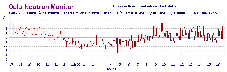

I noticed over on the SpaceWeather.com site they're reporting a "Forbrush Decrease" due to a CME sweeping away extra solar radiation. It does seem to coincide with my dip. Coincidence or related? We really need more Radboxes outside, right now!

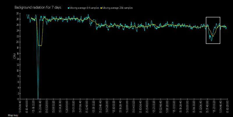

I think this diagram makes things a little clearer.
