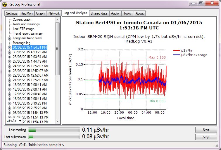

Bob, perhaps you can attach a jpg or png image of your Radlog window's graph tab; something may show up.
I have no trouble with ticking/unticking either of these 2 boxes; they work as expected for me without changing my graphed points. This is likely not related to Bob's issue, but what I see for the default 24 hours in the 'Show' box is not 24 but 20 hours of graph data. There is no data for the first 4 hours in the window (I think it's always shown this, but I thought it not serious enough to raise). The older graphs in the 'Log and Analysis' tab all show the same (see below). Could this be because my local time is UTC-4 hrs?

Replied by mw0uzo on topic Problem with RadLog graph
It has to be a time zone problem affecting the graph. Thanks both, I will get it fixed in v0.42.
