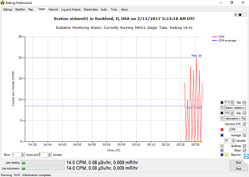

9 years 6 months ago #3045 by stdorn01
Replied by stdorn01 on topic Problem with RadLog graph
I have the same issue. I re-checked axis time UTC and it now graphs correctly. (I was only showing 2-3 datapoints on graph.)

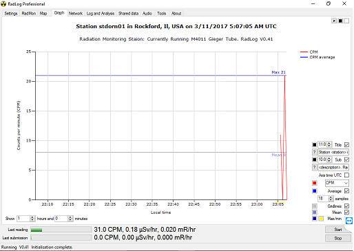

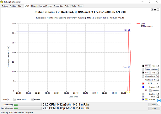

9 years 6 months ago - 9 years 6 months ago #3046 by stdorn01
I have attached screenshots @ 1,3,4,5, and 6 minute increments to show an example. all I did to cause this was uncheck the UTC box. The last post show 6 minutes with the UTC checked. I can check and uncheck the box while radlog is running with no issue but if left unchecked the graph messes up after closing and restarting radlog. If UTC is rechecked and rad log is restarted the graph works again. Hope fully this info will help with debugging.

9 years 6 months ago #3047 by stdorn01
