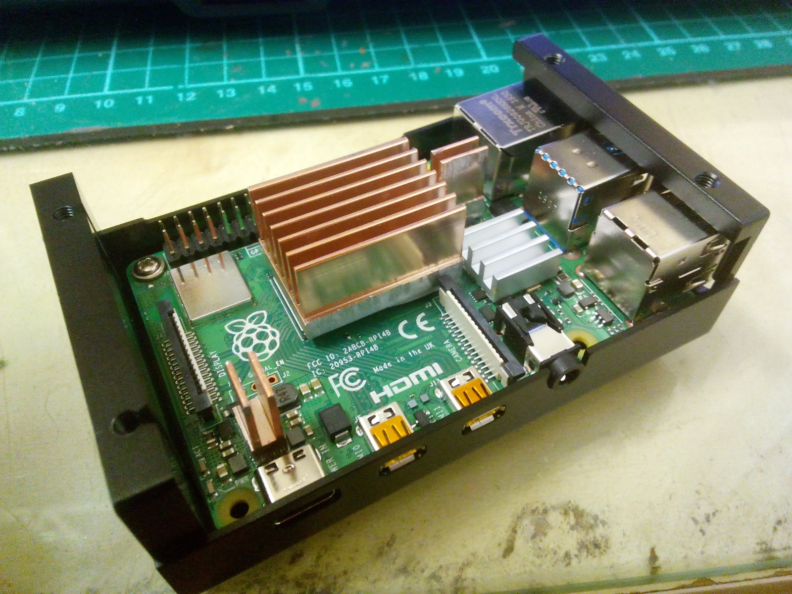

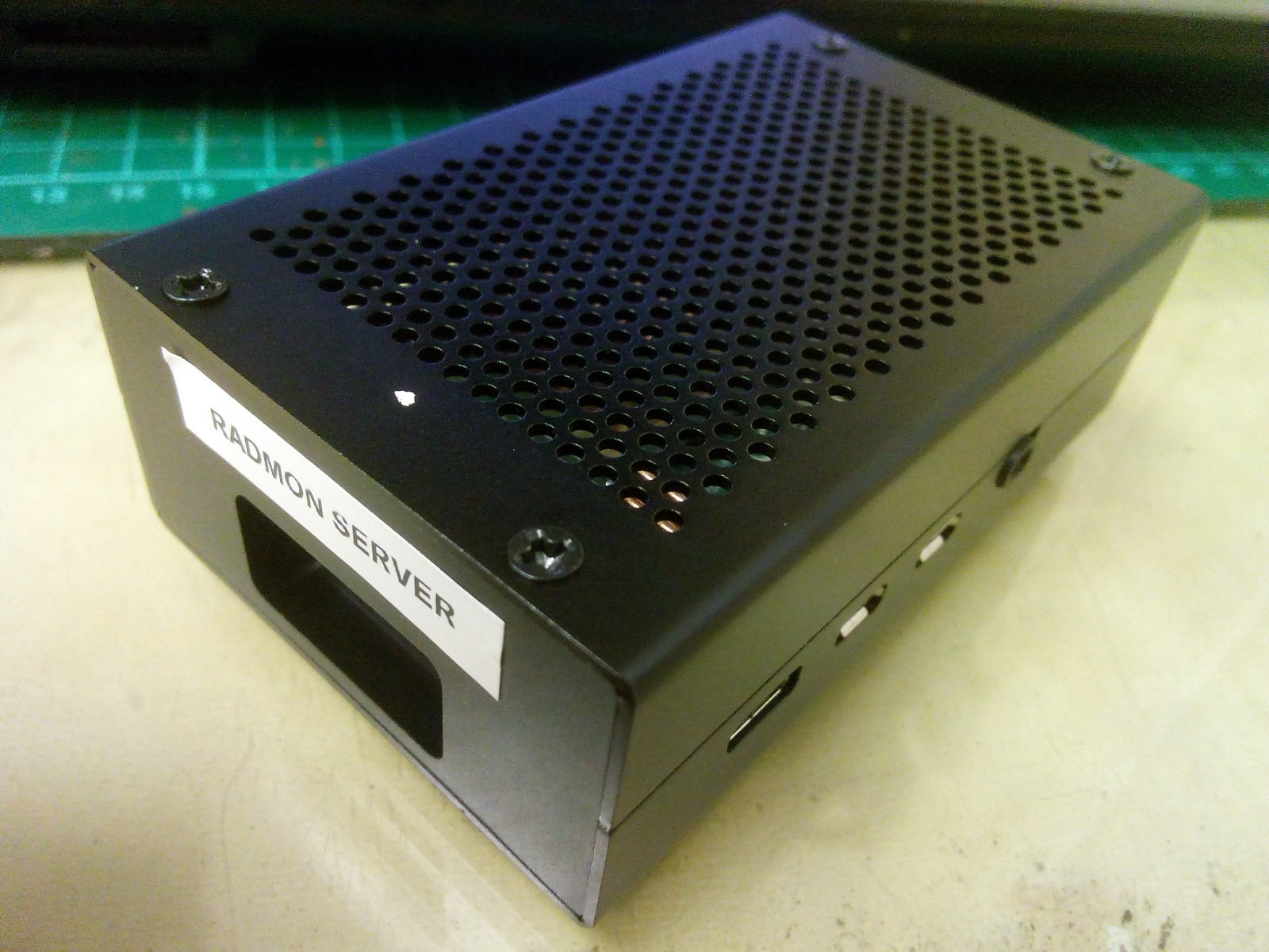

After a lost parcel inevitably containing the all important memory cards (why is it always the important components?) delaying things for a week, I now have them in my hands! So with a bit of luck I can get things running. It's not going to be completely straightforward as the server image is runs on x86 and it's got to run on the Pi which is ARM.

OK - It's running on the RPi4. Charts are broken at the moment due to old pChart library not working with PHP7.3. Looking for a fix... development halted on pchart 2.1.4 :/
