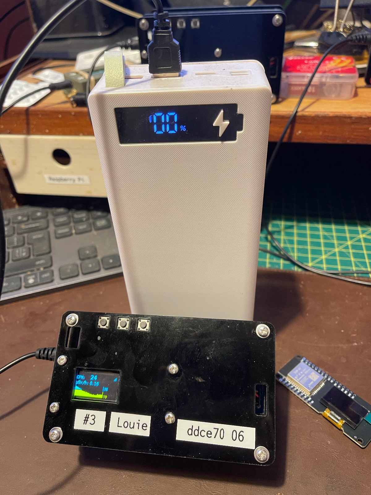

I was thinking... if you dump the internal battery could you fit an ESP32 into the battery compartment? Does it work without the battery installed?
Reason being in the past I bought a shed-load of faulty laptop batteries, from which I extracted all the good 18650s (usually only the odd failed cell which makes the entire battery faulty). So I ended up with hundreds of good 18650 cells which I tested and catagorised into sets. Then I bought a bunch of battery pack holders (they're cheap) and each one of those holds 16 x 18650 which I use to power projects long term. They are used to power Huey, Dewey and Louie. Now sure how long the power actually lasts but it should be a while. Anyway, I could also use one to power this counter via the USB-C charging port IF it will run without an internal battery..

I believe I can charge the battery banks while still connected and powering a device, I need to check but if that's true there's no need to ever disconnect the counter. I'm hoping the power bank can power he counters for a couple of months or so before needing to be recharged.
1 year 4 months ago #7376
Replied by ChrisLX200 on topic A little gem - The Yaorea YRG01 (Review & Mod)
No way am I going to get 2 months out of a battery bank, even big ones. I was thinking about the ESP32 but forgot about the 150-300mA the Cajoe boards eat up. So I found an old USB2 hub and with a 2A power supply can provide ~500mA on each port.
