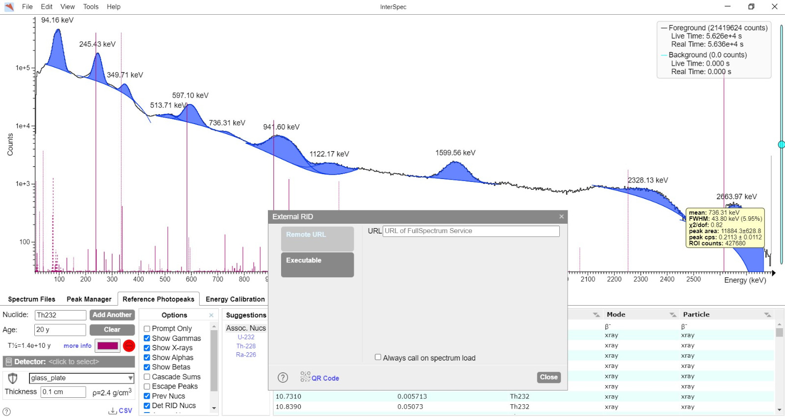

1 year 5 months ago #7199
Replied by ChrisLX200 on topic Monitoring using spectrograms?
Good points. If it were to be done then clearly it would involve uploading of 6/12hr .xml files at maybe 50-100kB each, and generation of any informative overview graph done on the server. That, or just uploading an image. Quite an overhead I guess. At the user end the only automation available I can see would have to use scripts, although saving > xml can be automated the uploading can not except possibly (those I've looked at so far) from InterSpec. However InterSpec does not do capture from devices - it's just analysis software (and very good it is too)
. BecMoni does data capture from Radiacode devices but has no upload function.
Trying to tease out components of normal background is a very difficult task, like you I tried 24hr captures and just about recovered K40. However, the spectrum would mostly be useful in the event of a notable alert that covered the country and in such circumstance the readings would be much higher and nucleides like Cs137, Co60 etc (not normally seen) more easily identified.

1 year 5 months ago #7201
My new 103 was out of cal straight from the box and I still need to recalibrate it. I have a method outlined using 3 peaks generated by thorium (I have a vial of thorium dioxide which is very active) and the BeqMoni software mentioned earlier. Just have to get a decent spectrogram and it will calculate the correct offset and write directly to the 103. Problem with all these small/cheap devices is that you can't get good calibration across the entire range of energies, it's either accurate at the low end or the top end but not both. ChatGPT sounds interesting I thought it was just a toy
