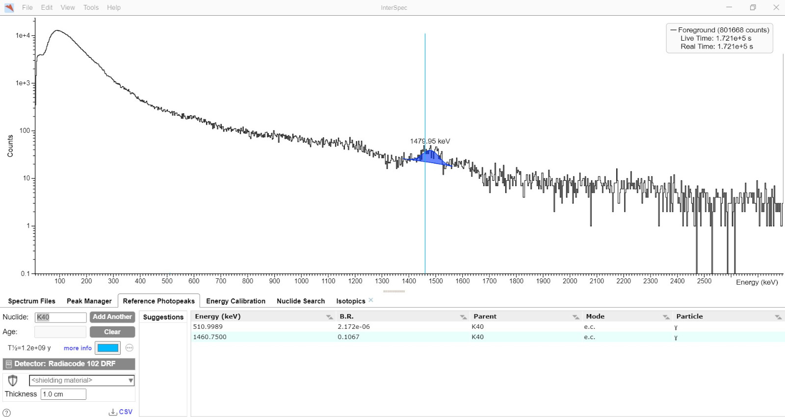

Data collection not quite complete (later today) but I have a statistically significant K-40 peak detected now.
Another interesting project is tobacco leaves which alegedly concentrate Polonium (I read somewhere) and that contributes to it's carcinogenic properties. However it is a weak alpha emitter so probably not easy to discriminate and so the 103 might not be up for it. Perhaps the 103-G would have been a better option for these experiments but it's a lot more expensive.

Nice. It will be interesting seeing your background and then subtracting it from the bananas spectrum.
