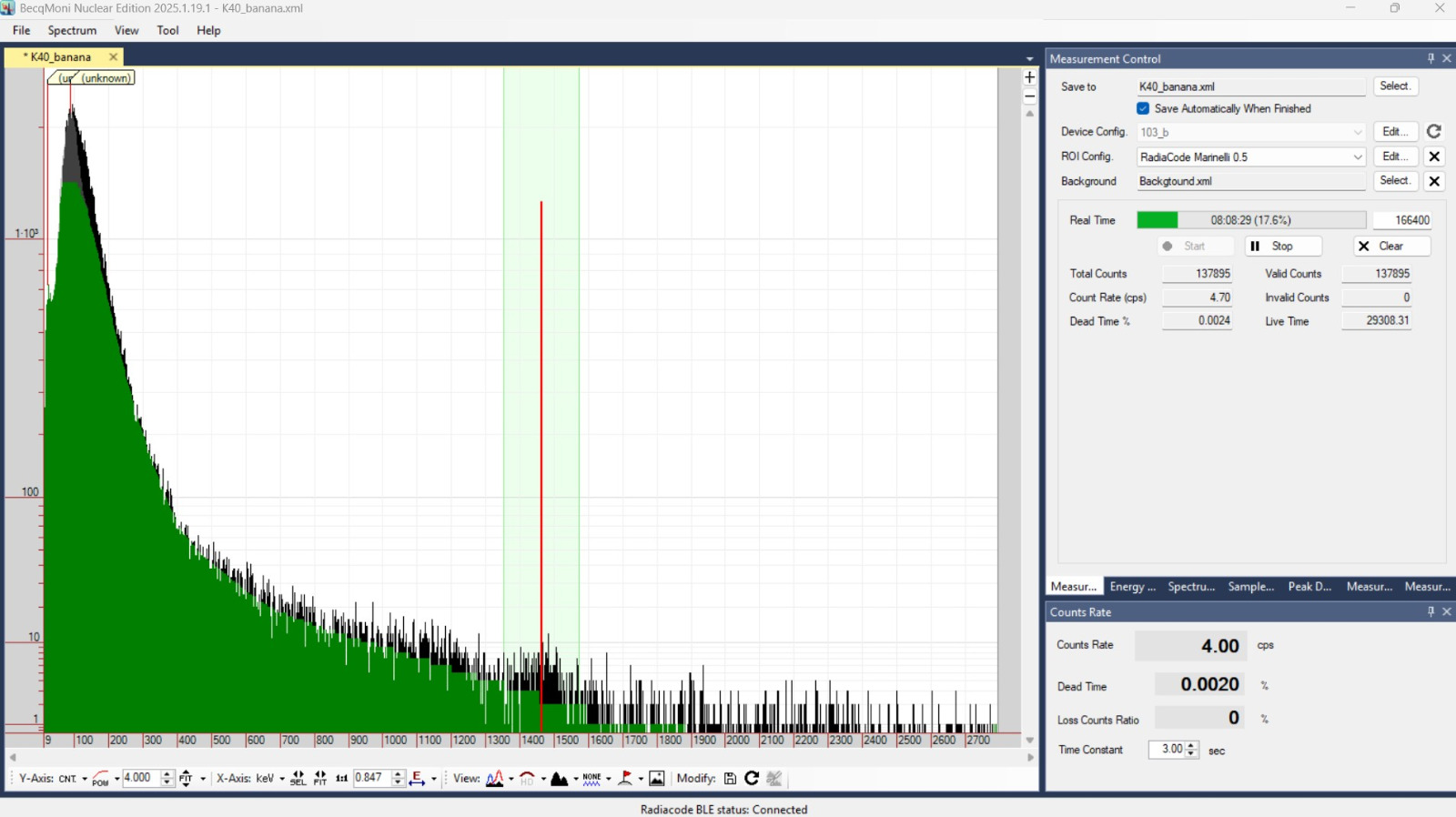

That's fascinating and I will investigate chatGPT further in the next week or so.
Currently my RC103 is sat on 3 bananas trying to see if I can detect K-40, there is visibly something there @1460KeV after about 5hrs but no significant peak detected. It's set for a 2-day aquisition (unless I eat the bananas first...)

Replied by Simomax on topic Monitoring using spectrograms?
Haha! That's a great experiment. However, your Radiacode will pickup K-40 naturally from the background so will be hard to tell if the bananas are contributing much. Once you have the two day acquisition from the bananas, remove them, reset the spectrum and collect again for the same time period. Then you can use the 2nd background plot to take off the bananas plot and you will see if the bananas actually did increase the counts.

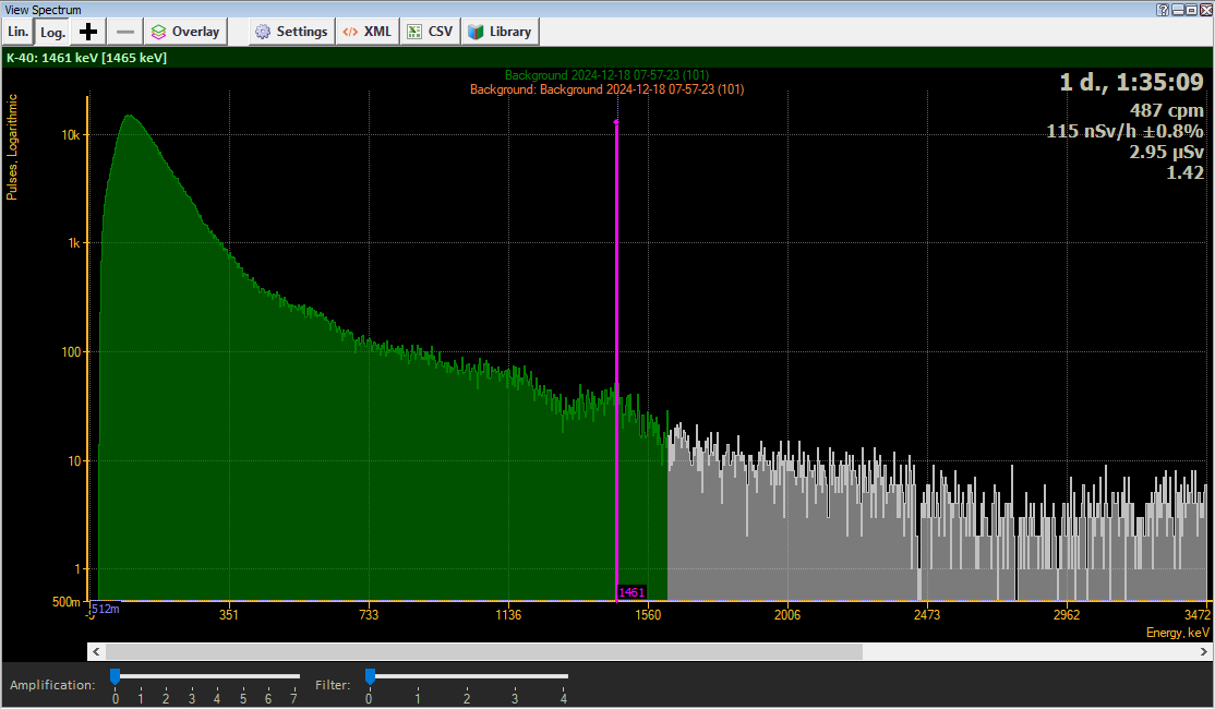

This image is 25.5 hours of just background from my Radiacode 101 after I re-calibrated it. It looks very similar to your bananas. To get around the small sensor size and lower sensitivity compared to larger scintillators, simply leave it for much longer so it has chance to gather those counts. I have left mine running for several days on some sources and I have got pretty good spectra with it.
