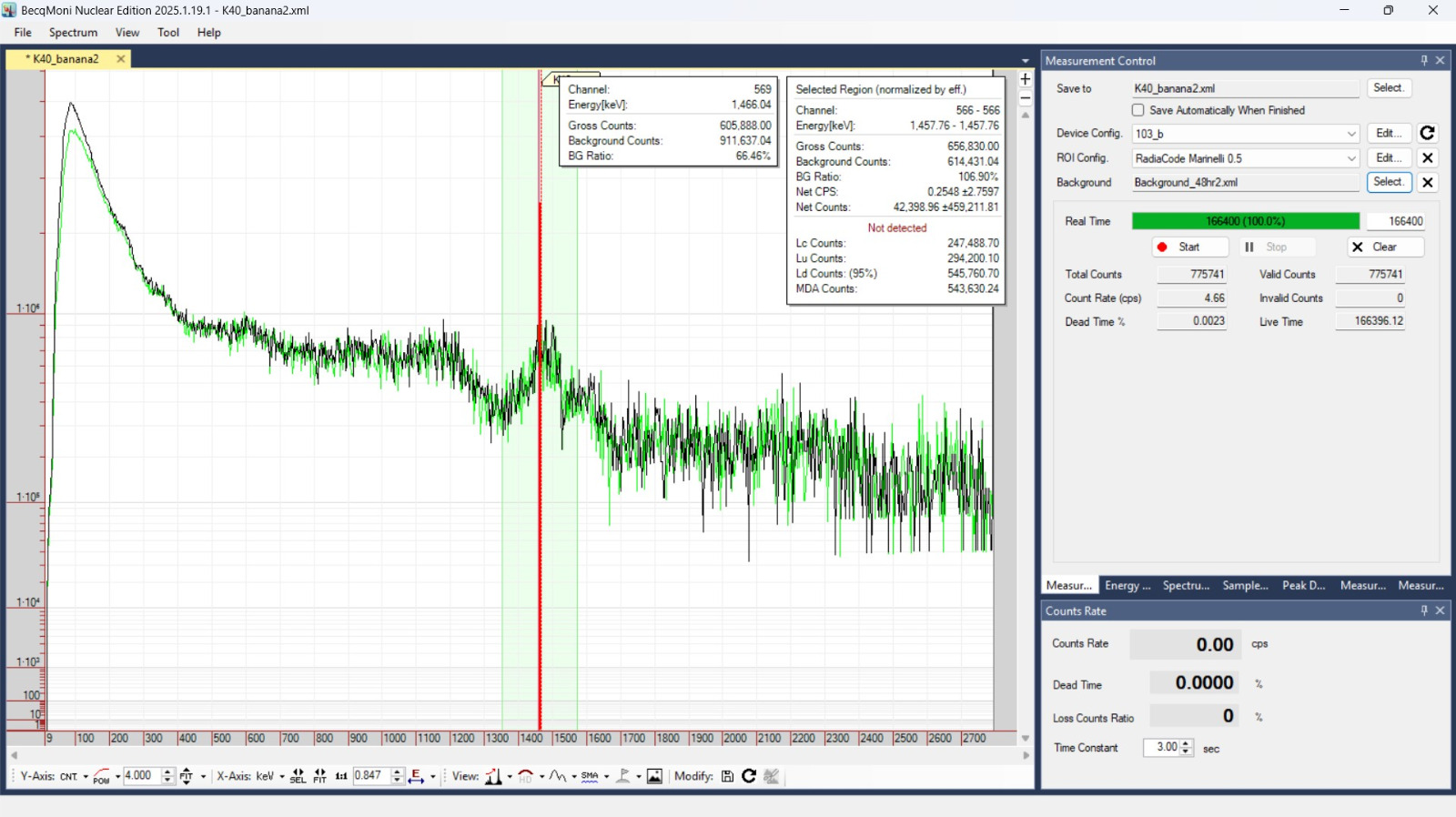

Detecting K-40 in bananas with Radiocode RC103 was created by ChrisLX200
To cut a long story short - no significant detection. Although a marginally significant peak was detected just looking at the foreground data after the background was subtracted there's nothing significant left. So it's not really present in my data. This was a 48hour capture. From what I can find it appears K-40 _is_ present in the banana skins but not in the fruit itself, and the activity level is very low in any case.
