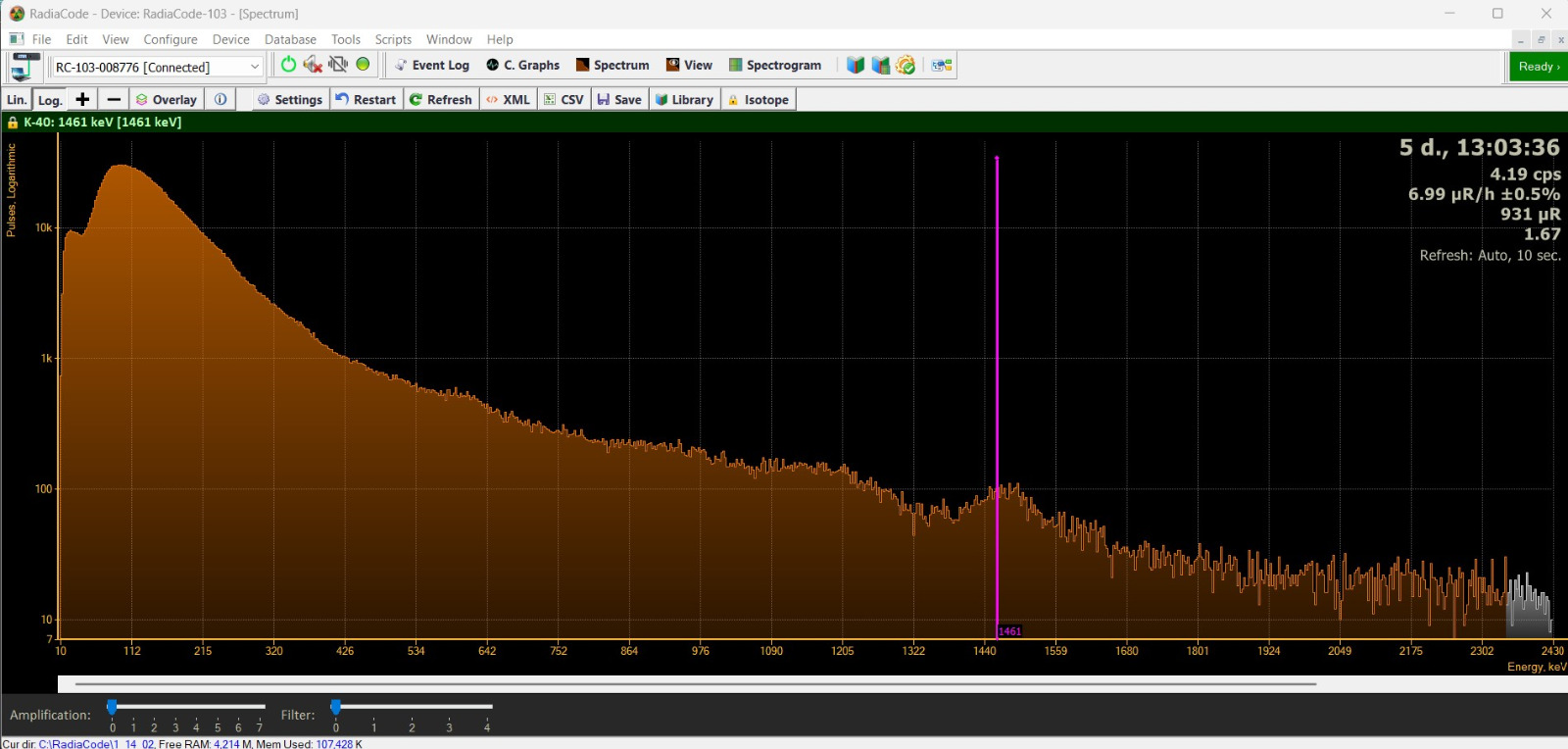

Up to 133 hours no the background capture now:
