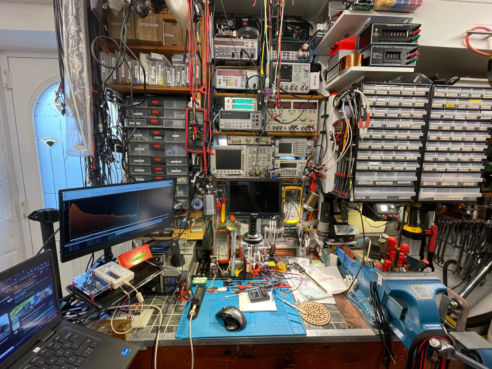

My Radiacode is just sitting on my electronics workbench in a corner of my garage, I thought there might have been interference from the surrounding instruments and sources (located at the far end of the garage) but there's nothing. However, when (if) the Radium source I ordered turns up I think I'll make a lead pig to contain it - and make sure it's in an airtight box. Last thing I need is to contaminate my workbench.

I have had little to no interference with all matter of counters and scintillators, and like your lab there (nice, BTW) I have loads of electronics around me. The only times I have had problems have been noisy power supplies, and the noise has always been through the power lines. Your Radium source wouldn't be one of those from the dial of a DP-63 Geiger counter, would it? I wanted one some time back but people were asking good money for them so left it. I believe they can be quite spicy!
