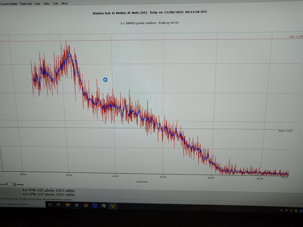

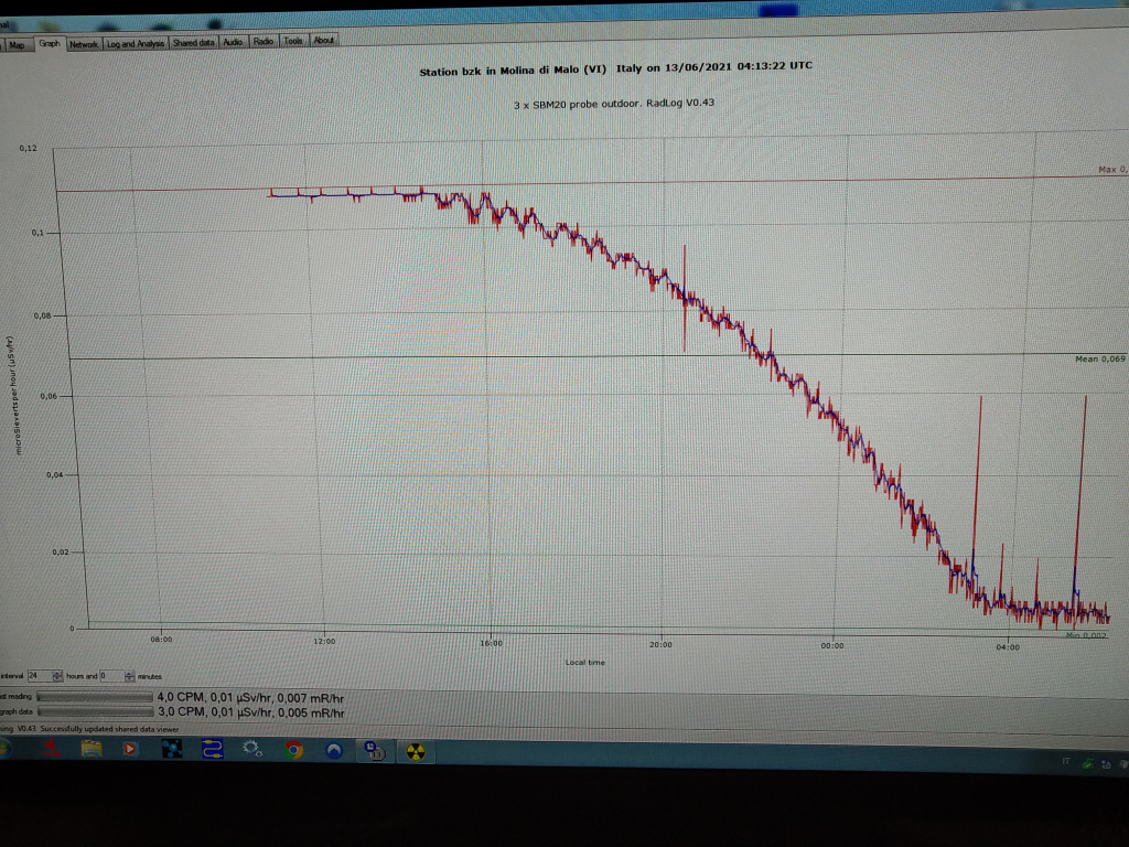

Hi all, they are some months that during data acquisitions, after some hours, the data decreased a bit. This is not due to radiation but as sure to the logger. To verify that I have changed 3 different computer and also by using a pulse generator as data source . With 1 Hz (60 cps) at 0.1 % of duty cycle (1 mS) for some4-6 hours the read is 60 cps. After that the reading decrease and after 24h tend to be 4-5 cps (seems to be a log decreasing). This situation became evident 3-4 monts ago. Before these date all registered daily graph (24h) where regular. The solution is to close and reopen program after 3-4 hours but the question is : why the data logger decrease the right reading after some hours with an absoluting stable pulse source? It's a bug? My data feed are by audio input.  On attach the first graph shows the real radioactivity acquisition during about 24 hours and the second by pulse over the same time. If I close and replay Radlog the starting point is correct.

MAYBE SOLVED. I have putted 60 seconds as audio acquisition time and with audio generator no more signal decreasing over 5 hours is shows. Now I am again online with real data.

NOT solved. By increasing audio acquisition time from 30 to 60 sec. the audio graph page become little bit better but after 4 hours this page, disabling zoom and trigger plot in order to obtain free run, show some freezes of 2-3 sec long. The freezes become more evident as number and cycle by time increasing.
