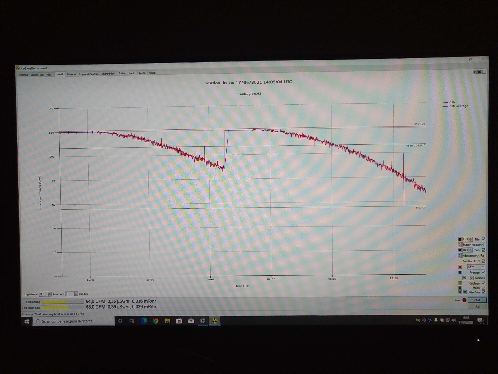

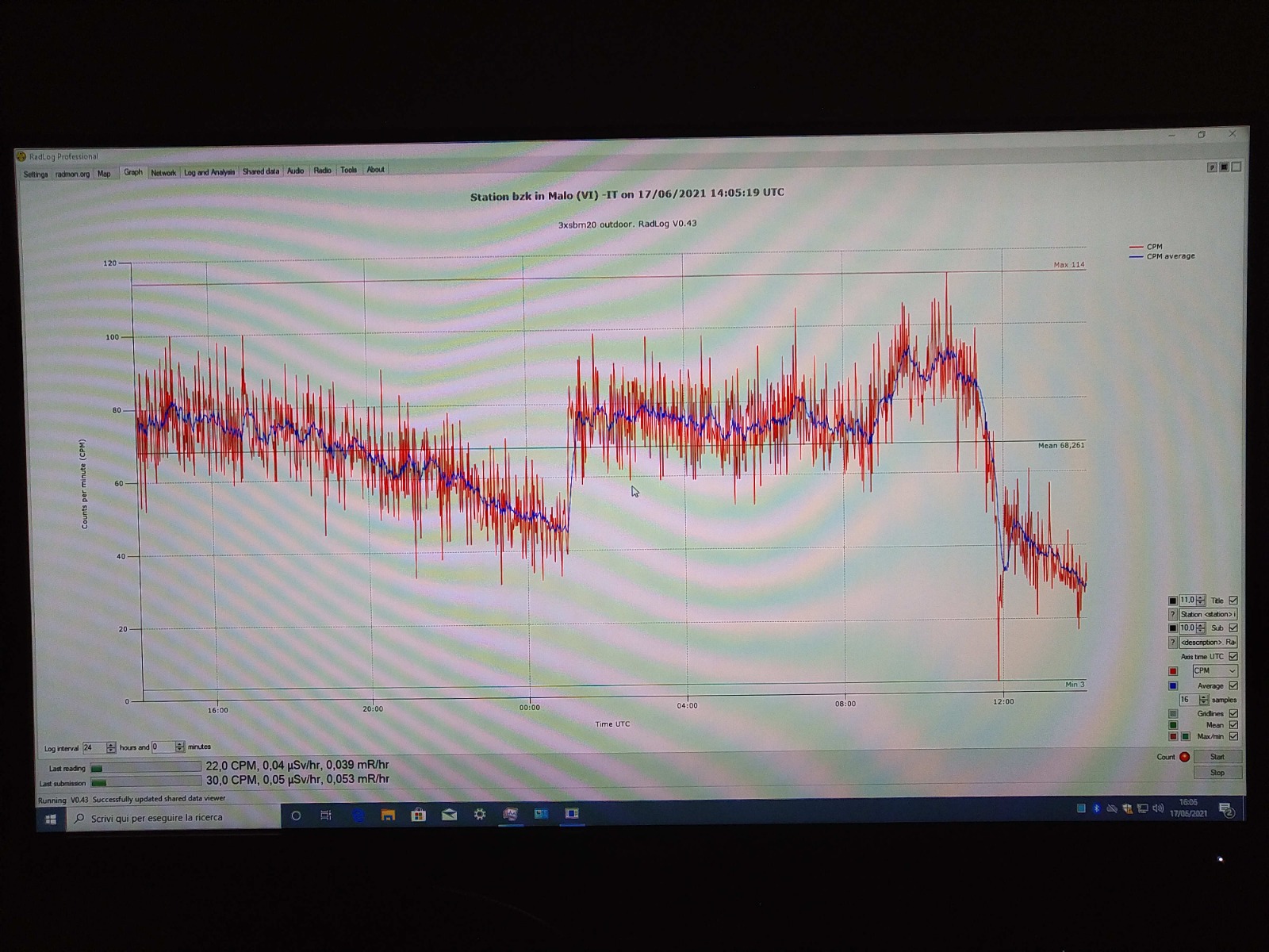

Definetively is a SW problem. First graph from MINIPC, fresh formatted with win 10 pro 64 bit and only Radlog fresh downloaded from site. Default configuration, only selected audio card; second an old desktop with win 10 pro 32 bit, audio pulse generator at 120 cps, same condition as before.
The graphs are evident. Please try to solve because from april i am unable to send consistent data.
