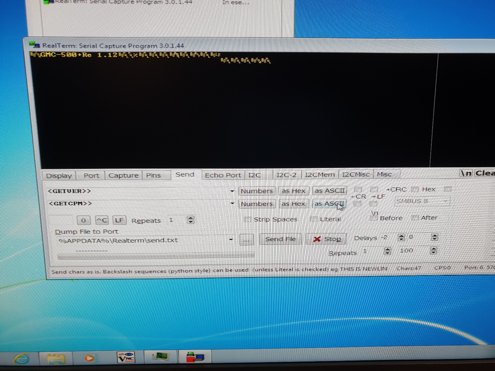

I dont know what I am doing wrong. In Real Term software I put everything like described above, but there is no way to write something in upper black window. I can just move white cursor left or right with mouse, bot that is all. No way to write something. What I am doing wrong?

Hi Marco, send the command with the ASCII button and he will reply as you see in the image. But if I send the GETCPM command, I do not answer anythingI dont know what I am doing wrong. In Real Term software I put everything like described above, but there is no way to write something in upper black window. I can just move white cursor left or right with mouse, bot that is all. No way to write something. What I am doing wrong?

Hi. I am done like above, but nothing happened. Screen is black.....

But have you set the serial port of the GMC 500 to 57600 baud ?

Hm no i am not my is still 115200. I will try that to....

I get now the information true com port: GMC-500Re 2.00
This is my ascii to HEX
47 4d 43 2d 35 30 30 52 65 20 32 2e 30 30
If I try hex to decimal nothing happened....
