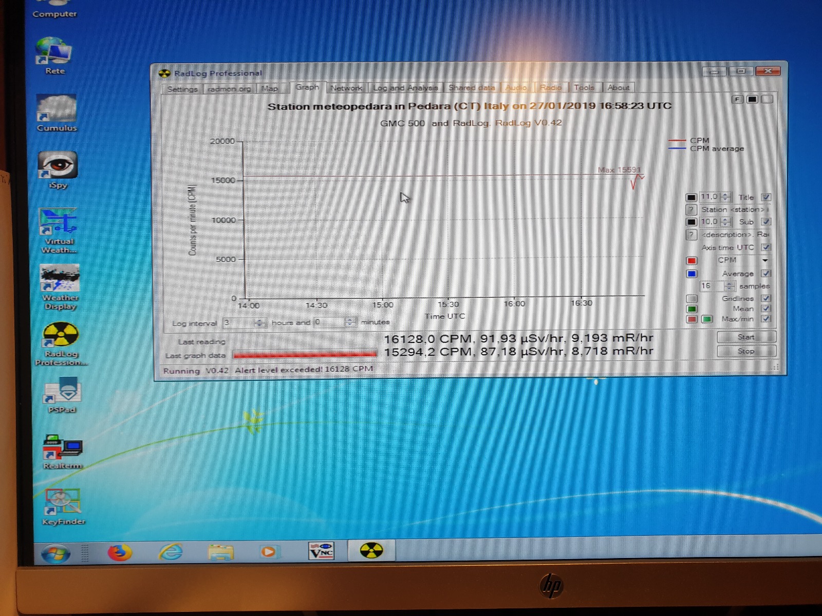

Hi to all. Finally I managed to get him to talk to Radlog. I set the GMC 500 at 57600 and also Radlog. As you can see from the attached photo. But there is a problem, as you can see marks strange numbers even if the correct size 500. I did a total reset but it does not change anything. Some idea?
