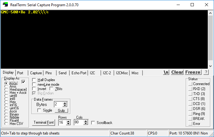

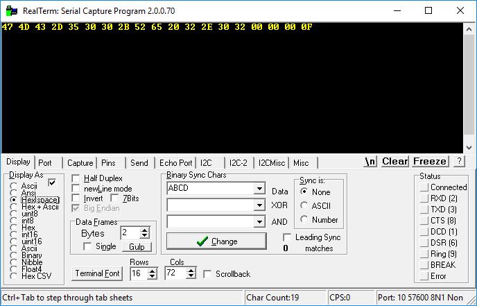

I have GMC500+. After <GETCPM>> it return not two, but four characters. Last character is in CPM, not uSv/hr.
Results:
15CPM - 00 00 00 0F
16CPM - 00 00 00 10
17CPM - 00 00 00 11
18CPM - 00 00 00 12
19CPM - 00 00 00 13
20CPM - 00 00 00 14
I made two screenshots after one click <GETVER>> and one click <GETCPM>>: First screenshot is in ASCI mode, second is in HEX mode.

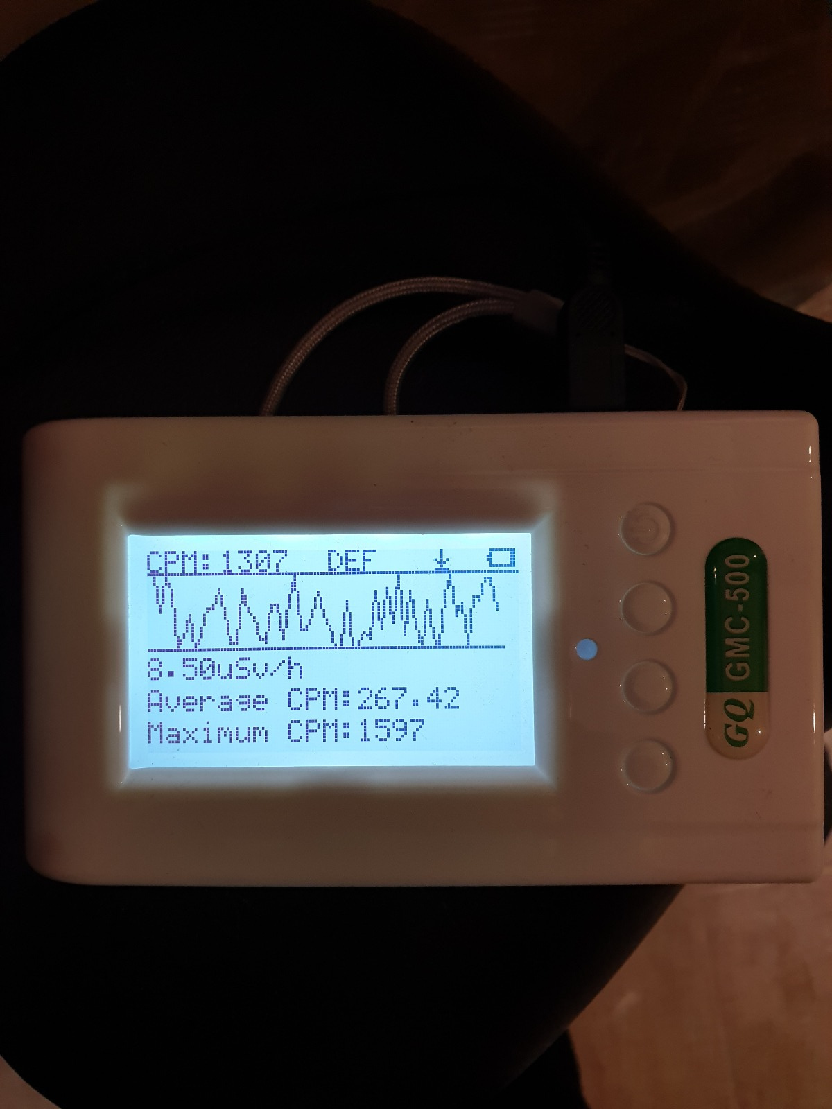

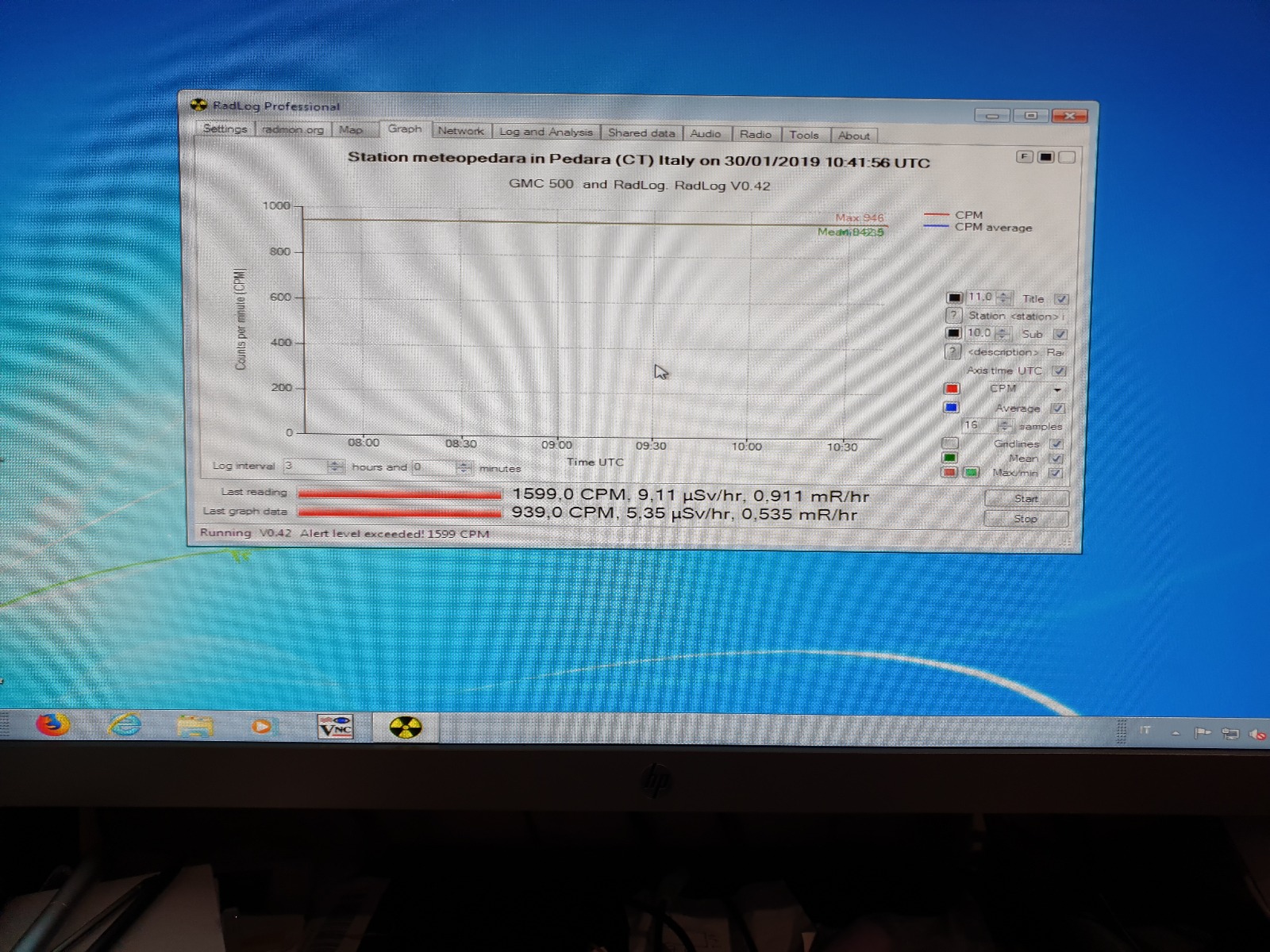

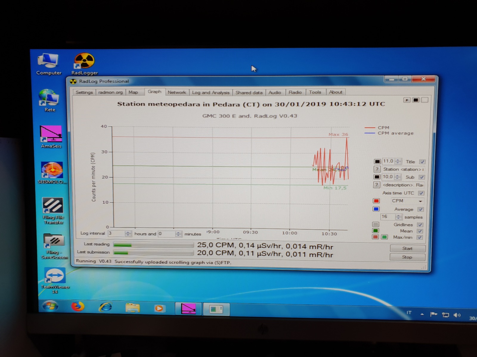

Hi Daniel and Marco, I have done further tests. I installed the GMC 500 ON A THIN CLIENT T610 with Windows 7 embedded, set the com port to 57600, far from the various lan cables, wireless router and PC with a five meters usb active . Now Radlog communicates with it. Except that, unlike the GMC 300, it reads a little higher values. I am attaching photos. What could it be?

Replied by s52sk on topic Problem with software
HI this is the same thing which also sometimes happened to me. This is I think results because too many times run and exit the program.
Marco
Marco
