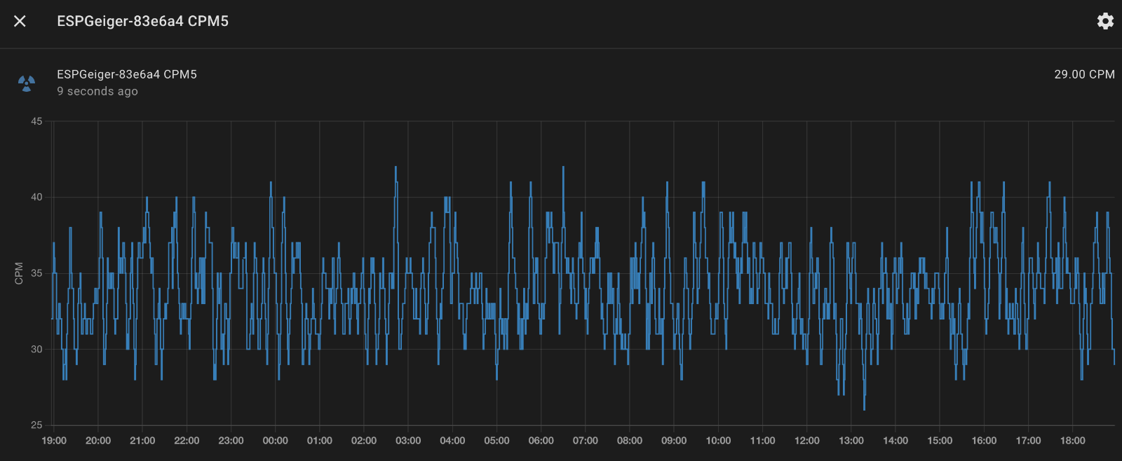

Homeassistant can be used to take the data in from MQTT and make visualisations - ESPGeiger automatically sets up some basic graphs within Homeassistant if MQTT is working properly -

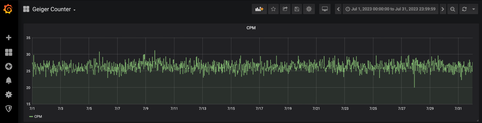

Some other options for storing data could be to feed InfluxDB from MQTT and then use Grafana to visualise the data

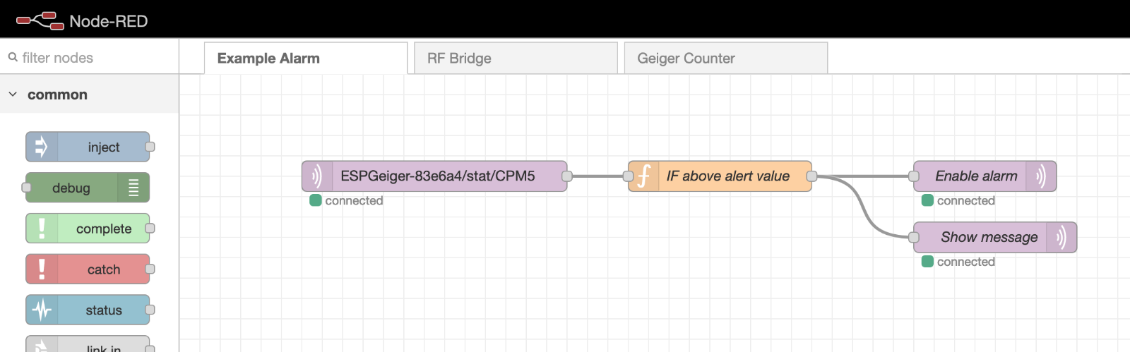

Using nodered you could make choices based on the input value and trigger other outputs
