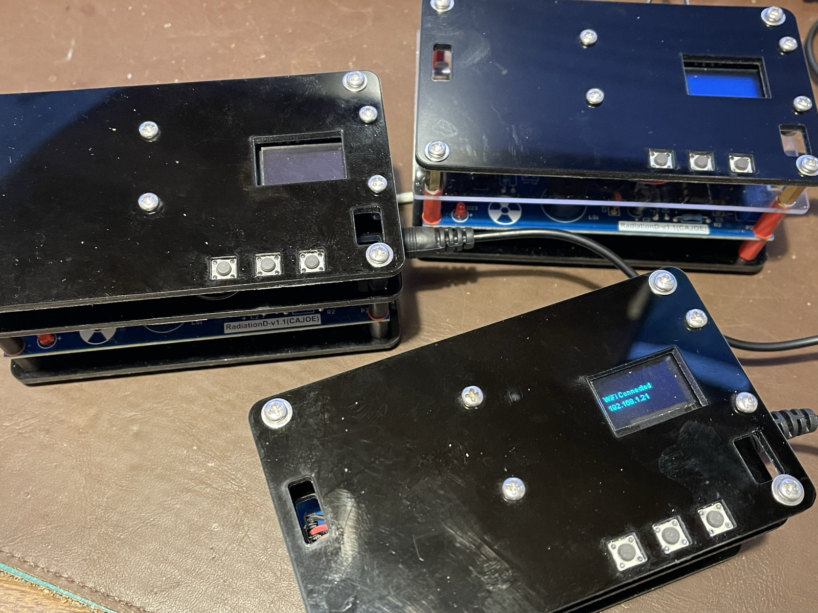

I need to check voltages on these Cajoe boards, I noticed current draw varied from ~150mA up to ~300mA between the three.

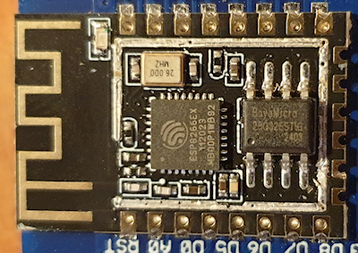

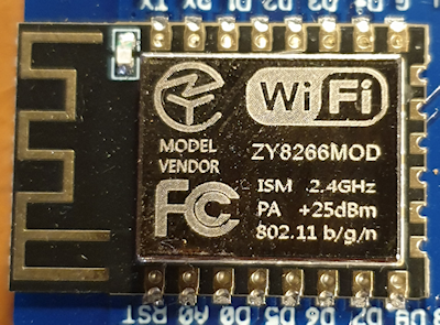

Ahh, I think you may have hit the nail on the head - not all ESP32's (or ESP8266's) are equal, as I have found out in the past. I generally stick to ESP32 Dev Kits v3/v4 (dev boards) and Wemos D1 Mini's or clones thereof. I have had a handful of different ESP modules over the years with little to no joy getting them to work easily, as in straight out of the box. As you are using a Meshtastic (I think) type of module, this may use a slightly different flavour of ESP32. In fact, looking at the metal can on yours the text is a little different. I generally use the ESP32-WROOM-32D ESP32's and ZY8266MOD ESP8266's, and since sticking to those two specific flavours, which seem to come on nearly all dev boards, I have hardly had any issues. You will be able to get others working, but will probably require specific settings for the memory/speeds/DIO mode (I forget what that is, but fell over it once!) etc. So it's just a matter of getting all of your ducks in a line and then it should work. For ease of use I just stick with the two I have been using.
Under the metal can on an ESP32/ESP8266 there is more than just the main MCU. You can see in the picture (of one I blew up earlier ) there is also an 8-pin SOP, which I think may be the EEPROM. Some have different memory capacities and there may be other differences. Putting it all together there could be 4,5 maybe 6 settings that all need to align with the actual MCU module you are using.

, I've been a model engineer for many years and have a capable workshop. I've actually added 3 interface buttons to the Cajoe/ESP32 cases now. The other two will likely be used for switching display screens but right now two of them are redundant. It was just easier to do it while I had them apart, just pop them in the laser cutter and it cuts out the little square holes for the switches.
