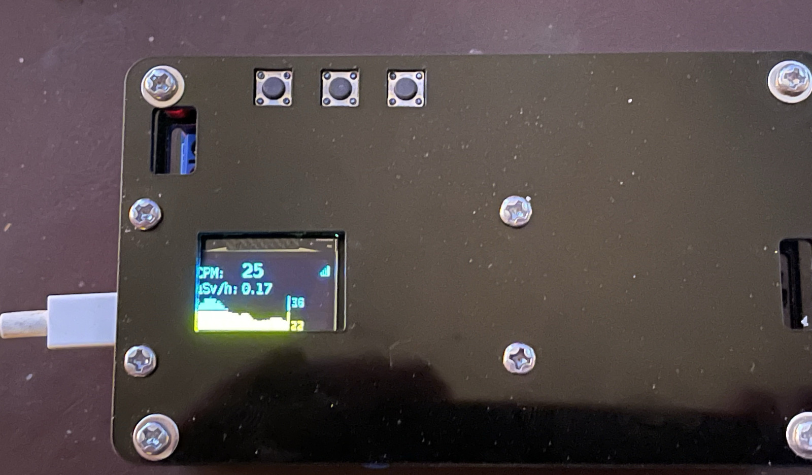

It seemed to start uploading to Radmon OK but now I just see 'Unknown Errors' in the console when it tries. I'm not sure what I'm doing here, I just put my name/pswd in the config fields and let it rip. Is there something else I should be doing?

Well that's the thing, this new counter doesn't have a name... I don't have Radlog Pro running on this office PC - the upload machine is in my workshop. I'm about to install it now on this PC if that's where I configure a new counter to upload? Of course there is no parameters to set in ESPGeiger other than name/pswd. I'm probably being thick here... Anyway, the console is reporting Upload Success at the moment.
OK, I think I figured it out. Username for the 3 counters I want to add are:
ChrisLX200_ESPGeiger_J305b_1
ChrisLX200_ESPGeiger_J305b_2
ChrisLX200_ESPGeiger_J305b_3
I've disabled attempting to upload for now the data is obviously not correct

Yeah I named them so I can tell which one is which
They're all running fine now but I need a clue how to get multiple counters uploading to my station account, and how to add details for each in the descriptions. Do I actually need you to add them or can I do it myself?
