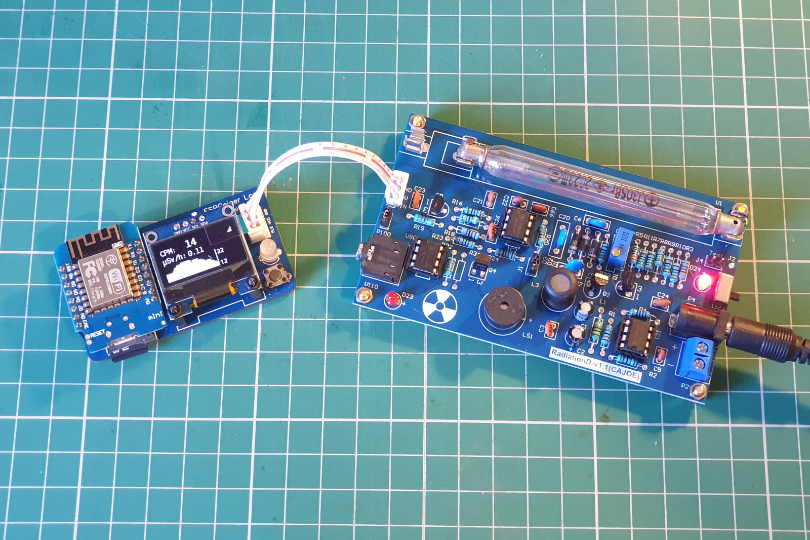

ESPGeiger Log
Over the Christmas break a new ESPGeiger device was designed and made a reality - ESPGeiger Log - this was the original hardware intended for the ESPGeiger firmware.
Image credit: SimoMax
The ESPGeiger Log is designed to give a clean and reliable connection between ESPGeiger and your Geiger Counter.
It is compatible with all Pulse and Serial based Geiger counters that ESPGeiger natively supports.
ESPGeiger Log features a SD Card for minute to minute recording of the current values from your ESPGeiger - providing up to 20 years of minutely resolution on a 2GB SD card.
The current state of the environment can also be monitored colourfully and quickly understood by the use of an onboard ES2812 neopixel LED.
The recent history can be seen by use of the SD11306 OLED screen and of course if comes with all the other features of ESPGeiger - such as uploading to radmon.org and your designated MQTT broker to mention but a few options.
It's the perfect partner if you want to make your existing "dumb" Geiger Counter smarter by connecting it to the world of Radmon and IoT in general. It also provides a cost effective, stable way to locally log your radiation environment hands-free.
If there is interest I have also started looking at options for enclosures for the ESPGeiger Log and will be providing STL files free of charge so that you can have an even neater experience with your ESPGeiger Log.
I'm hoping to start selling these on Tindie in the coming days. If you are interested drop me a note here and I can forward you a link.

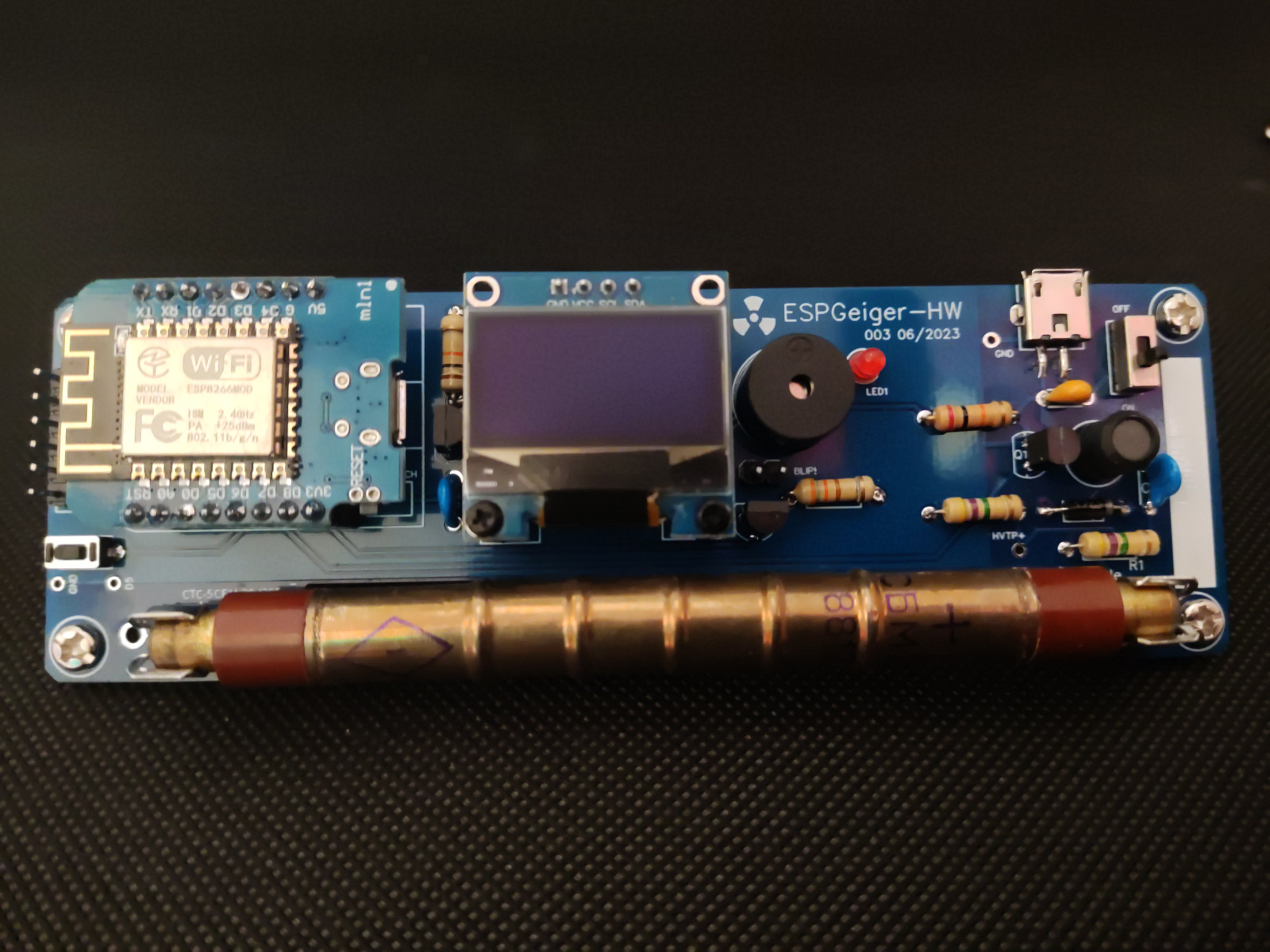

ESPGeiger HW
ESPGeiger HW is a fully fledged Geiger Counter powered by ESP8266.
A number of evaluation boards for ESPGeiger HW have been sent out and tested. Testing has been underway for ease of construction, use and stability. Feedback has been acted upon and a number of newer revisions have been made.
Neverending thanks to SimoMax of these very forums for being so generous and kind with his feedback regarding the ESPGeiger HW.
I'm presently preparing a Tindie store to host and sell the devices from.
I'm hoping to be offering a number of options, from barebones kits that require assembly, to pre-assembled ready-to-go Geiger counters including Geiger-Muller tube.

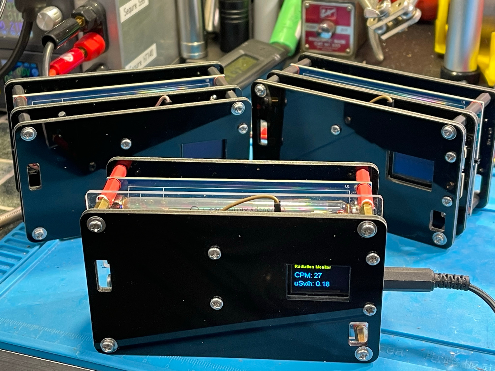

Edit: I have the 3 boards assembled now and all the J305b's have the same date code and are not UV sensitive. They seem to be producing similar background counts but that will need confirmation of course.
