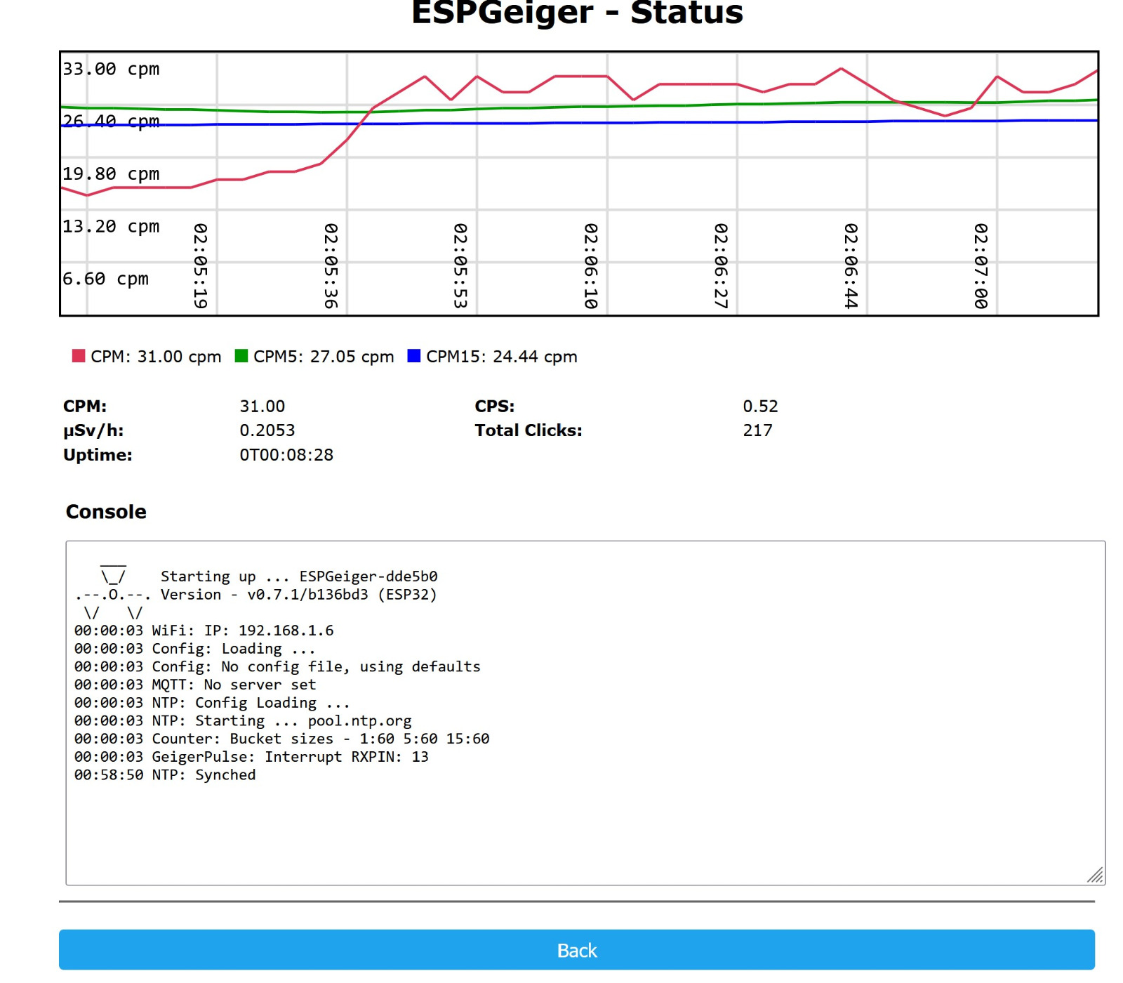

Replied by ChrisLX200 on topic ESPGeiger
Web install not updated yet so I downloaded the 'merged' bin file (which has the bootloader included) and at first it failed. I didn't realise I had to change the offset from 0x1000 (default) to 0x0. Loaded ok and seems to be running. I configured the WiFi stuff and have the portal config screen, so I'll see how that goes.

It actually wasn't working - the counting was poor/absent. I was beginning to think the wiring was supect but it was correct. Then I thought it was a bad connection but I saw the same behaviour on counter #2. I installed the NOPCNT version (no SP32 hardware counting) and it now works perfectly. So wiring good - code not so much.
