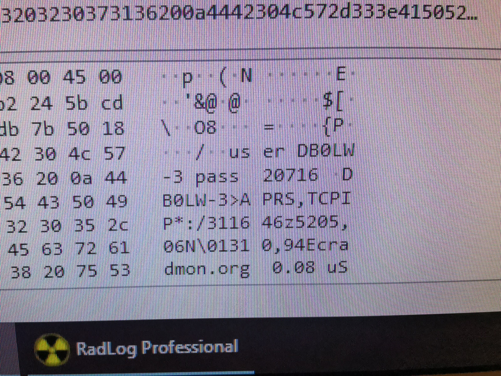

This time i will analyse the stream with Wireshark and i found my first problem:
I used a family DNS Server in my router so the IP from euro.aprs2.net was not found in my network.
I change it in my AVM 7490 Fritzbox now.
Now the stream is working (i can see it with wireshark with the TCP Filter 14580) but i think the coordinates in the mask are not set correct this time.
So the APRS Server will not accept my APRS position.
But i dont know if my settings of position are correct in the mask?

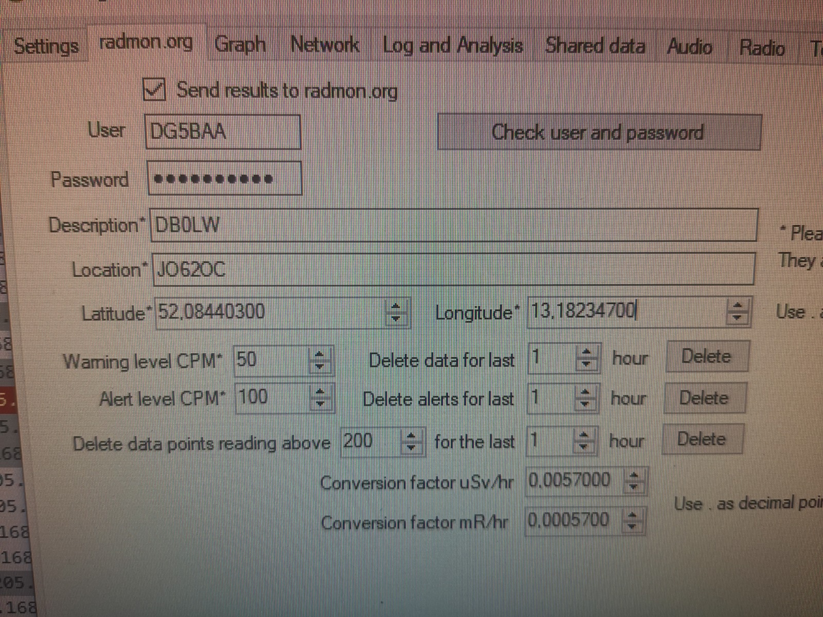

I set in this pictures my aprs node DB0LW.
I will use it as a beacon with radlog measurementy...
Can anyone tell me of the position is set correct in the mask??
Thank you!
Carsten DG5BAA (C4FM Node DB0LW)
Thank you!
