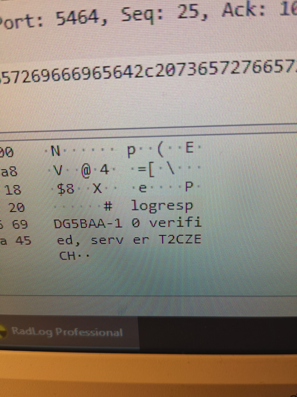

4 years 8 months ago #5980
by DG5BAA
Replied by DG5BAA on topic Report measurements to APRS via internet (only internet,not HF)
Update:
I see that the server accepts the request but i still dont see my measurements from aprs.fi...
I once set up the Bluestack Android Emulator dor APRSDruid on my Win10 computer and everythink works with it...
What can it be?
Carsten
What can it be?
Carsten
