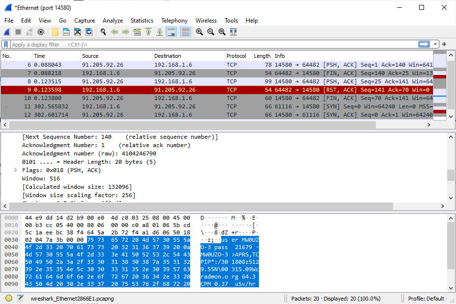

It all looks good, I tried SSID = 3 and that's OK here too.
Install Wireshark
Start a capture of Ethernet (or your primary network interface) with filter 'port 14580'
Run radlog,Start and wait for 5-10 mins
There will be several packets captured - look for one around 193 bytes in length, that contains your callsign
Install Wireshark
