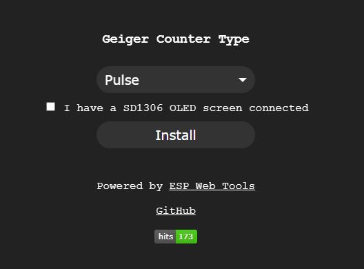

hello, i have one cuestion:
i have the device D1 Mini and, when i try to install firware say;
WebOTA is recommended. Download the latest firmware from GitHub and upload via the web interface.
I go to github and download file : ESPGeiger.cpp i think this is the firmware
But how i upload this? where is the web interface? thank you.

I don't quite understand how to connect via WiFi to install the firmware; I thought it was already installed with what I just did, but it seems that's not the case.
Is the firmware the ESPGeiger.cpp file?

The screenshot you posted suggests that the firmware is not yet installed. Click on "INSTALL ESPGEIGER PULSE v0.4.2" and follow any further prompts. Once you've installed the firmware using that web page, reboot the esp. Then the esp will be a wifi hotspot. I just connected my phone to the esp hotspot and set the wifi ap credentials from there.
