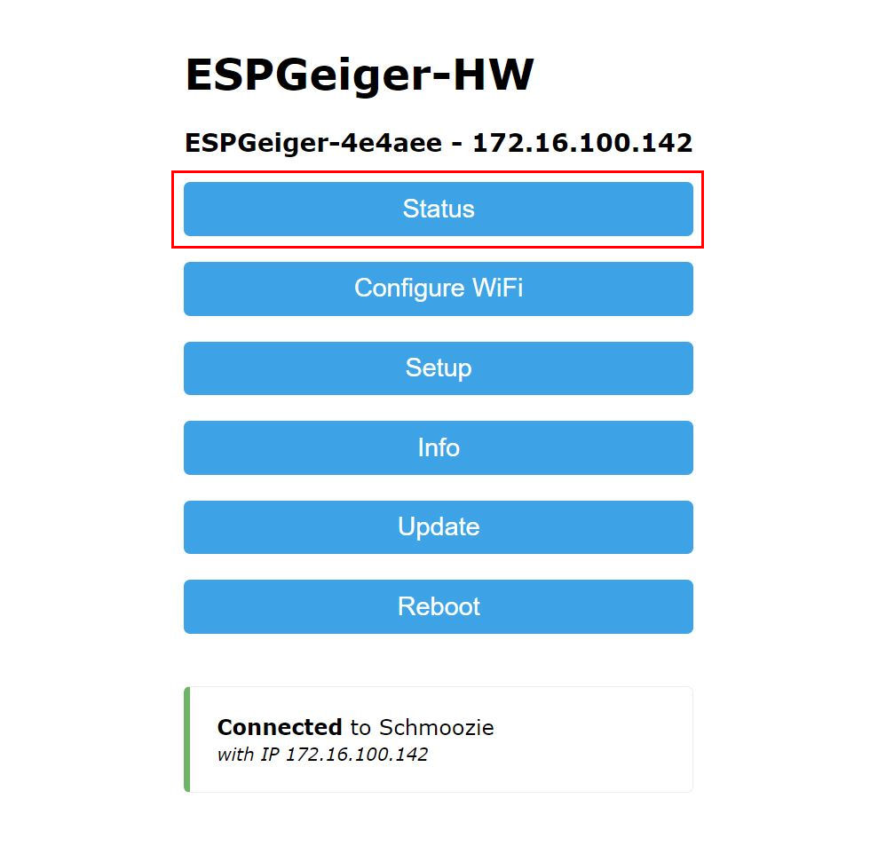

"I have a small problem: when I enter my credentials and save them, the blue light on the D1 Mini turns off, and the connection disappears. I can no longer connect through it."
- steadramon
- Senior Member
- Posts: 40
- Thank you received: 13
2 years 10 months ago - 2 years 10 months ago #6743
by steadramon
This means it has now connected to your WiFi.
Now you need to reconnect to the D1 Mini on your home network using http://espgeiger-xxxxx.local in your web browser (replacing xxxxxx with the ID you connected to) or the IP address given to the D1 Mini by your router. You can also connect to the Serial of the D1 Mini using USB and look at the output there for the IP .
Then you will see the main page as shown by Simomax
Replied by steadramon on topic My geiger doesn't seem connected

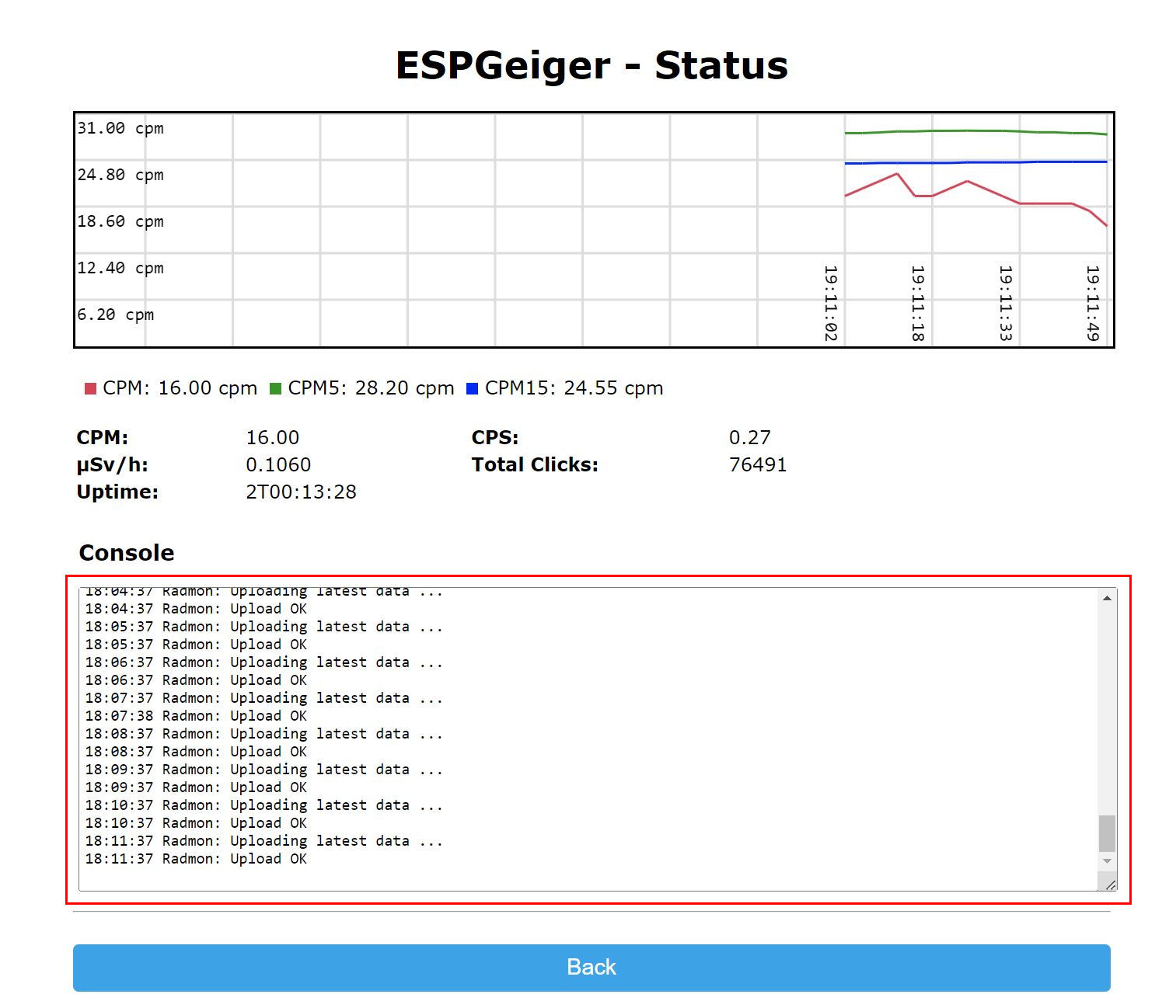

I have checked the recent logs and I can't see any submission by your username . Can you browse to your ESPGeiger and see the status page? At the bottom of the status page there is a log. Can you leave it running for 5 minutes, then copy and paste the log here.
You should see something like this, when it is working correctly.
18:02:37 Radmon: Uploading latest data ...
18:02:37 Radmon: Upload OK
18:03:37 Radmon: Uploading latest data ...
18:03:37 Radmon: Upload OK
18:04:37 Radmon: Uploading latest data ...
18:04:37 Radmon: Upload OK
18:05:37 Radmon: Uploading latest data ...
18:05:37 Radmon: Upload OK
18:06:37 Radmon: Uploading latest data ...
18:06:37 Radmon: Upload OK
18:07:37 Radmon: Uploading latest data ...
18:07:38 Radmon: Upload OK
