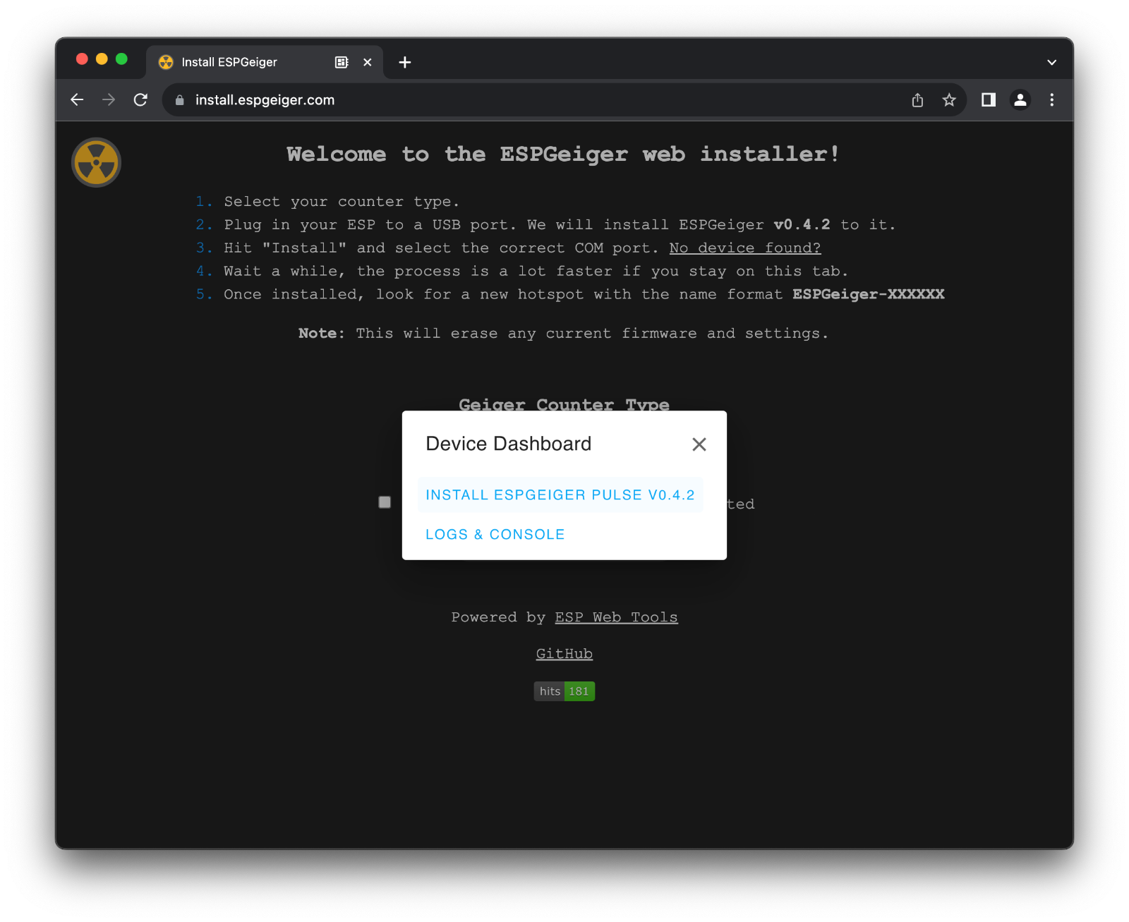

Now you should be able to use your phone or laptop to connect to the new WiFi hotspot - the format is ESPGeiger-XXXXXX (make a note of this for later)
Follow the instructions to connect the ESPGeiger to your home network.
Once connected to your home network you can now connect to it using the IP address or http://ESPGeiger-XXXXXX.local
Replied by steadramon on topic My geiger doesn't seem connected

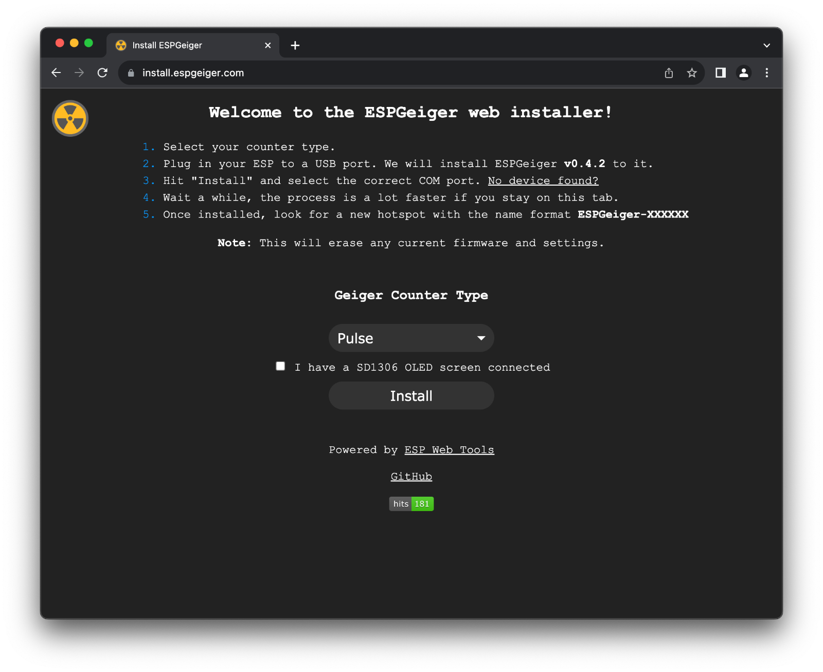

- For most situations, connecting an ESP to a Pulse counter, choose Pulse
- Click Install

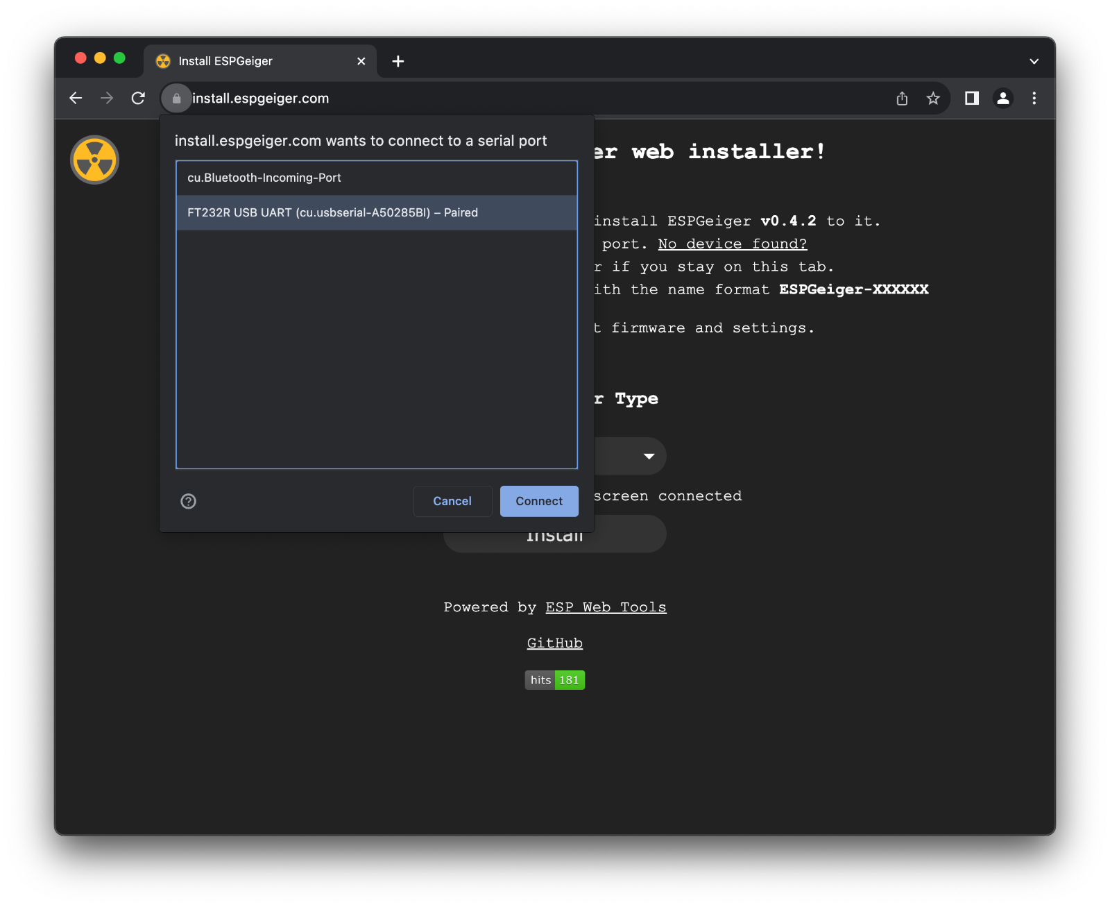

- Choose the Serial for your ESP
- Click Connect

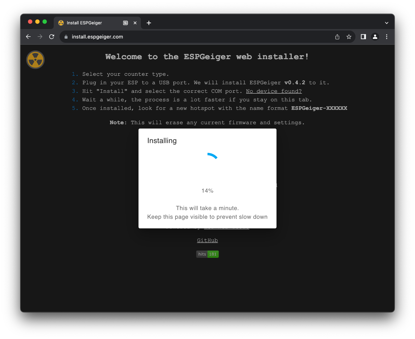

- Click Install ESPGeiger

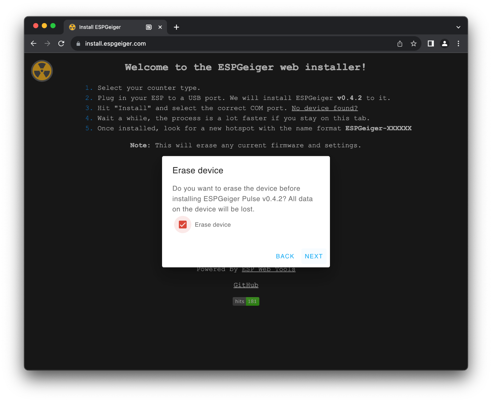

- Select Erase if this is your first installation or you need to reset to defaults

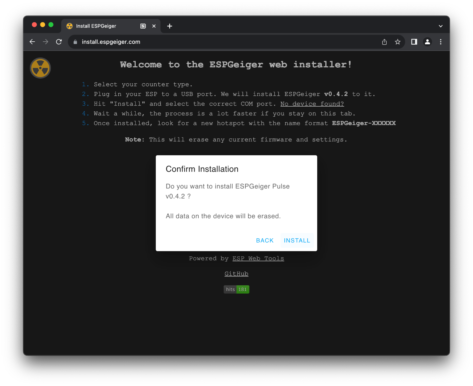

- Click Install, again, to confirm installation

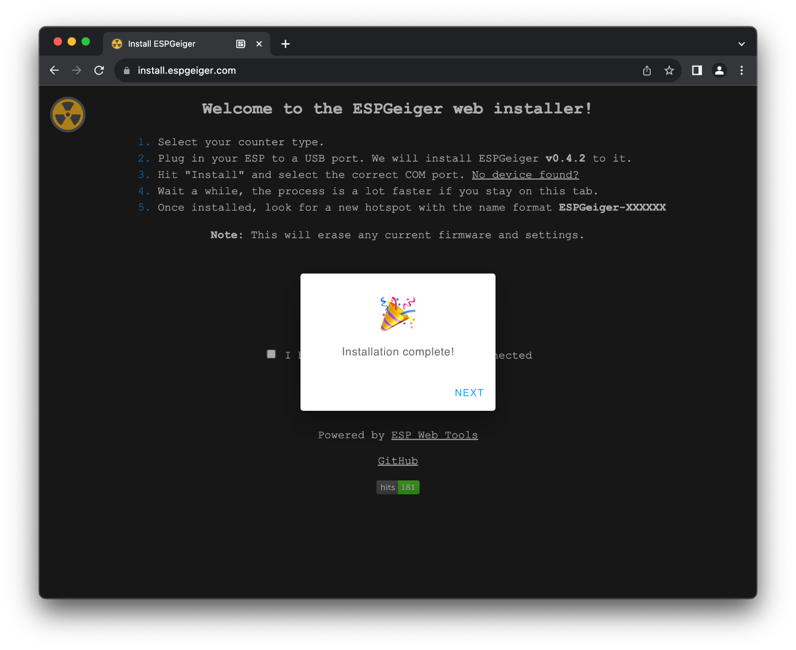

- Wait for the install to finish
- Install has finished
