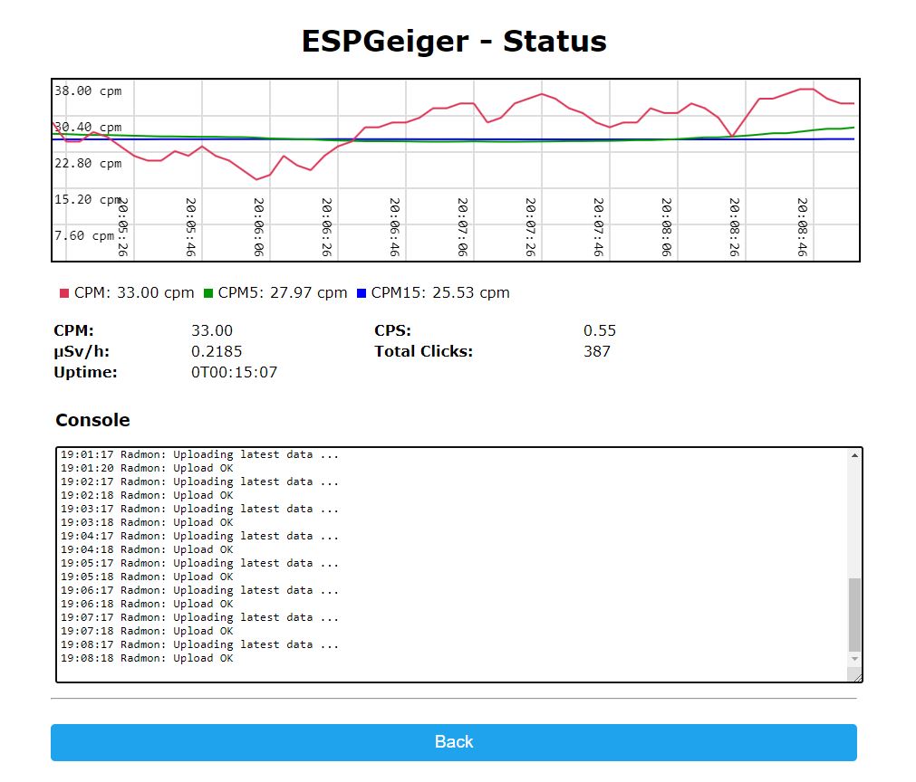

Your status page should look something like this. But I see that your CPM is at 0. I looked back at the picture of your setup and I can only see 2 wires connected to the ESP. It's obviously 5v and GND that is connected, but you also need to connect up D7 on the ESP to VIN (I think) on the CA JOE. It needs 3 wires to work. Once you connect that wire see what happens, and check your log and CPM readings.

Okay, this is good, were making progress. Please check that your radmon.org username and password are correct in the ESPGeiger 'settings' page. Type in your password, don't copy/paste it in.
Also, go to the 'info' page, and copy/paste everything on that page here.

NOW IS WORKING....I LOOK ON THE MAP
